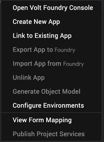

- On the upper-right corner of the screen, select Data & Services.
Click the contextual menu icon
. A list of options appears.
Select Generate Object Model. The generated models, which represent the server app model, enable CRUD operations on the underlying Volt MX Foundry objects.
Model API enables an application to work in online and offline modes without changing the application code. App developer supplies mode (offline or online), while making API calls on the models.
