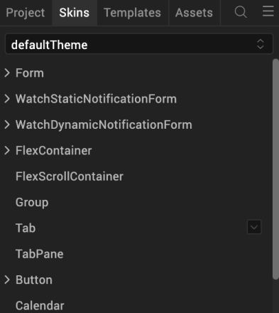

To view the default skins navigate to Project Explorer and click the Skins tab.
Click on a widget to view the default forms.

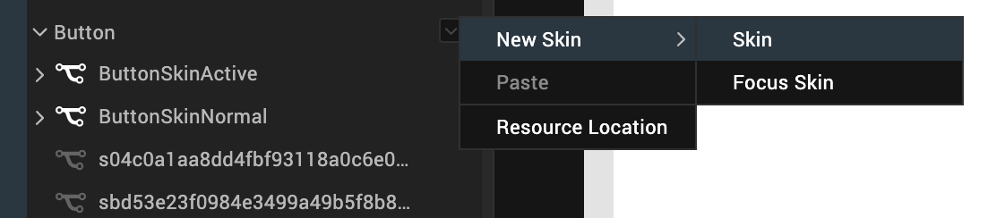

To create a new skin, do the following:
- On the Project Explorer, click the Skins tab.
- On the Skins tab, locate the type of widget that you want to create the new skin for, such as a Button, and then click that widget type’s context menu arrow
From the menu, click New Skin, and then click the type of new skin you want to create. Many widget types offer just the standard Skin, while others also offer a Focus Skin, or some variation.
Your new skin is created and is ready for you to configure.

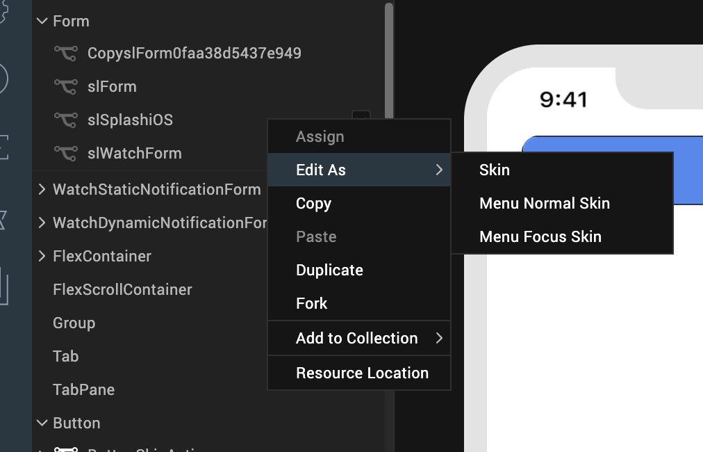

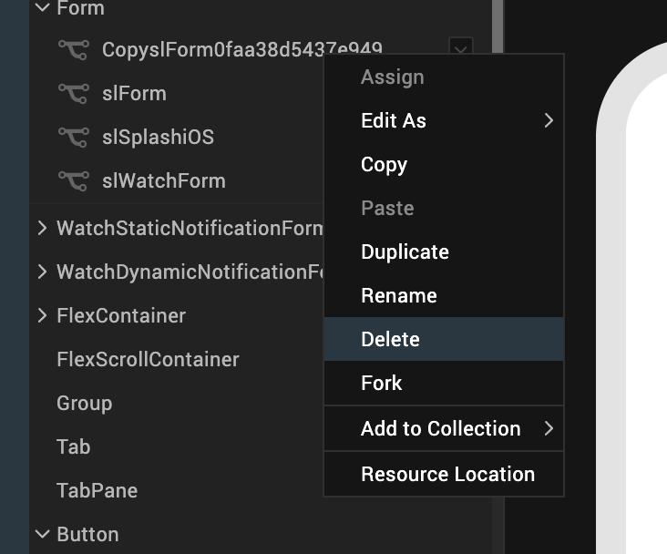

Rename the Skin
When you create a new skin, Volt MX Iris generates a unique name for it. And while you're welcome to keep the name that Volt MX Iris generates, you might find it more useful and easily recognizable if you rename it. You can rename widgets in two primary ways: using the Skins tab of an individual widget, and using the Skins tab on the Project Explorer, where the skins of all widgets are listed.

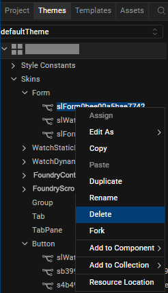

To rename a skin using the Skins tab on the Project Explorer, do the following:
- On the Skins tab, locate the type of widget that the skin you want to rename is categorized under. If the skins currently don't appear under the type of widget, click the widget type to open the category and display the skins.
- From the list of skins, hover over the skin you want to rename and click its context menu arrow
to open the skin's context menu. - From the skin's context menu, click Rename.
- Type a new name for the skin, and then press Enter.

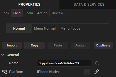

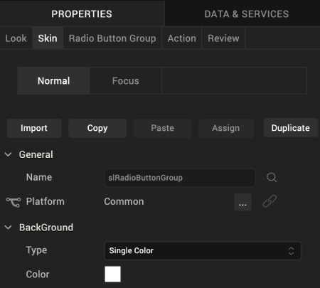

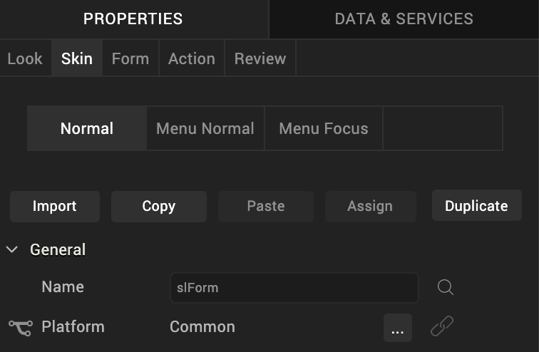

To rename a skin using the Skins tab of an individual widget, do the following:
- On the Iris Canvas, locate a widget that's using the skin you want to rename, and then select it.
- in the Properties Editor, click the Skins tab.
- In the Name text box, type a new name for the skin, and then press Enter.

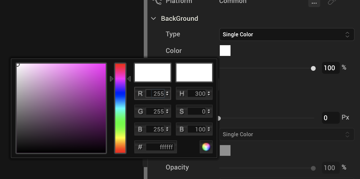

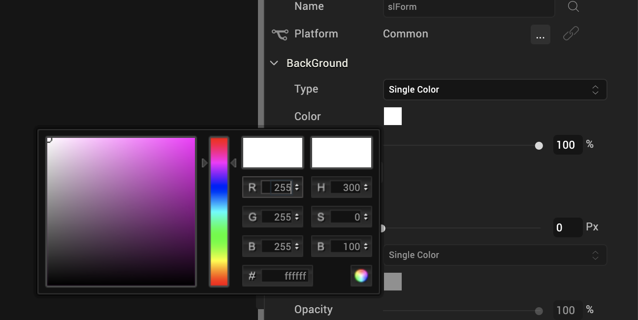

Single Color
Click the square color icon to open the Color Palette window.
To select a particular hue, on the vertical color bar drag the two opposing arrows to the hue you want, and then change the hue’s lightness, darkness, and saturation by dragging to the desired location on the large color square. You can also assign a color by changing the RGB values, the HSB values, or pasting a hexadecimal value from another program into the # text box. To close the Color Palette window, click anywhere outside of it.
- By default, the opacity is set to 100, making the background completely opaque with no transparency. However, if you want the background to have a degree of transparency, you can decrease its opacity. To do so, type a value between 0 and 100 in the Opacity text box, or drag the opacity slider to the degree of opacity that you want.

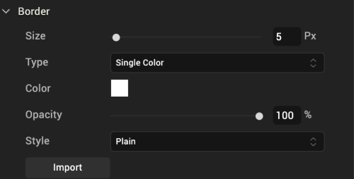

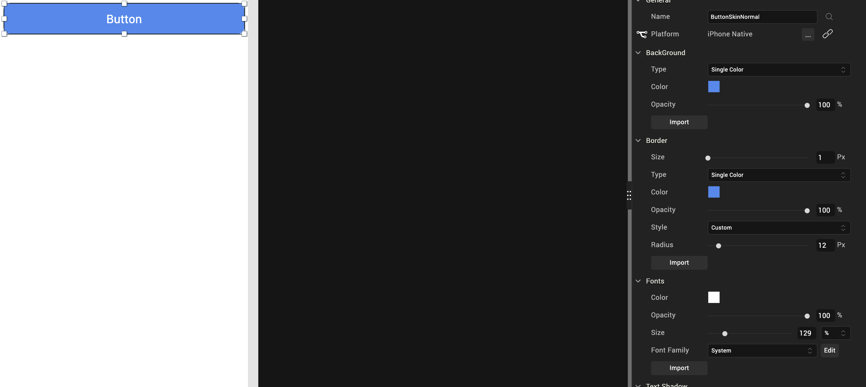

Set the Skin Border
The Border properties on the Skins tab become activated when the border width is greater than 0. Upon setting the border size to 1 or greater, the other border properties become editable. For the border color you can pick a single color or a multi-step gradient. And you can change its opacity.
Configuring the skin border for an SPA environment is slightly different. For more information, see SPA Borders.
To configure the skin border, do the following:
- In the Border section of the Skins tab, set the Size property to at least 1 pixel by either entering a number in the Px text box, or by moving the Size slider to the desired position.
In the Border section of the Skins tab, click the Type drop-down list and select the type of border you want, either Single Color or Multi Step Gradient. Instructions for how to configure each type are as follows:
Single Color

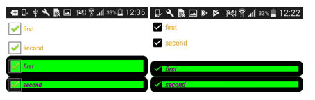

Also, In case of native channels, for style = plain, multistep gradient will be visible during design time. For other style values, i.e. roundedCorner, completeRoundedCorner, custom, the multistep gradient will be visible/applicable post build only. -

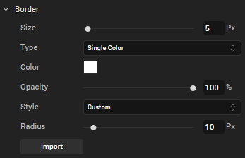

In the Border section of the Skins tab, click the Style drop-down list and select the type of corners you want, either Plain, Rounded Corner, Complete Rounded Corner, or Custom. Instructions for how to configure each type are found in the following table.
Border Style Instructions Plain Plain border corners have a sharp 90 degree angle. To give a border plain border corners, click the Style drop-down list, and then select Plain. Rounded Corner Rounded border corners with an opacity of 0 look like this:
Click the Style drop-down list, and then select Rounded Corner.Complete Rounded Corner Complete Rounded border corners with an opacity of 0 look like this:
Click the Style drop-down list, and then select Complete Rounded Corner.Custom With Custom border corners you can round the corners as deeply or shallowly as you want. - Click the Style drop-down list, and then select Custom. Set the Custom rounded property between 1 and 100 pixels by entering a number in the Px text box, or by moving the Radius slider to the desired position.

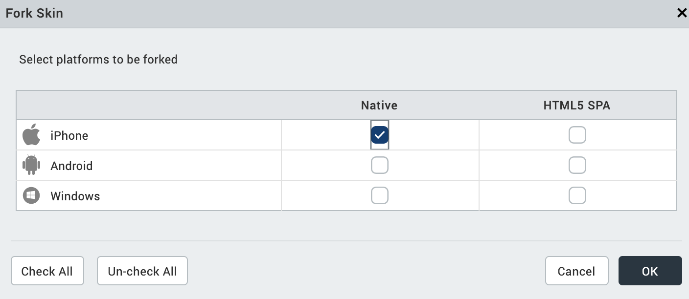

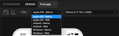

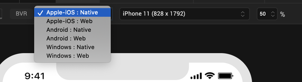

SPA borders can be applied when you have forked a form to the SPA platform. For more information, see Forking a Form.
You can modify the following border properties of a widget on an SPA platform:
Size: When you fork a widget skin for an SPA platform, you can either set unique values for each side of the widget border or set the same value for all the border sides.

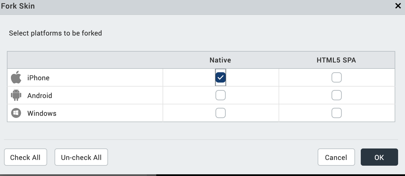

Rounded edges can be applied for widgets on skins forked for Android and Windows native platforms.
Note: Android/Windows native platforms support configuring individual corner radius. Configuring border properties for each of the four edges of a given widget is not supported by Android/Windows native platforms.
To set unique values for each corner, do the following:
- Click the border indicator
. The indicator changes from grey to blue. - Either type the value or using the slider, set the uniform border values.
- Border values are not retained if you unfork a widget skin.
- Perform the above steps for all the border corners.

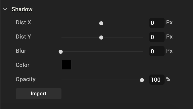

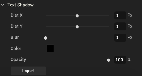

Set the Skin Shadow
Note: Shadow feature is available only when a skin is forked.
You can modify the following shadow properties of a widget:
- Dist X: Denotes the horizontal shadow distance away from the widget. When a positive Dist X value is entered the shadow is moved to the right-side of a widget. When a negative value is entered the shadow is moved to the left-side of a widget.
- Dist Y: Denotes the vertical shadow distance away from the widget. When a positive Dist Y value is entered, shadow is moved to the top-side of a widget. When a negative value is entered the shadow is moved to the bottom-side of a widget.
- Blur: Denotes the shadow blur of the widget by allowing you to soften shadow.
- Color: Denotes the color of the shadow. You can select a shadow color by clicking the Color Picker.
- InnerShadow: Click this check box if you want the shadow to display inside the widget. Otherwise, clear the check box to display the shadows outside the widget.
Set the Skin Font
You can modify the following font properties of a widget:
- Color: Denotes the font color. To modify the font color, do one of the following:
- Select a color. To do so, click the square color icon to open the Color Palette window. To select a particular hue, on the vertical color bar drag the two opposing arrows to the hue you want, and then change the hue’s lightness, darkness, and saturation by dragging to the desired location on the large color square. You can also assign a color by changing the RGB values, the HSB values, or pasting a hexadecimal value from another program into the # text box. To close the Color Palette window, click anywhere outside of it.
- Reuse an existing color. For more information, see Copy and Paste a Color or Gradient.
- Opacity: You can change the opacity level of the font color.
- Size: You can set the font size by pixels (0 to 600) or as a percentage (0 to 600) of the baseline font size of 28 pixels.
Note: The Volt MX Iris framework, however, consumes only percentage-based values for font size. As the px values are purely representational, you must use percentage-based values while setting the skin's font size.
Note: In iOS devices with OS 13, for certain font sizes, you will observe spacing.

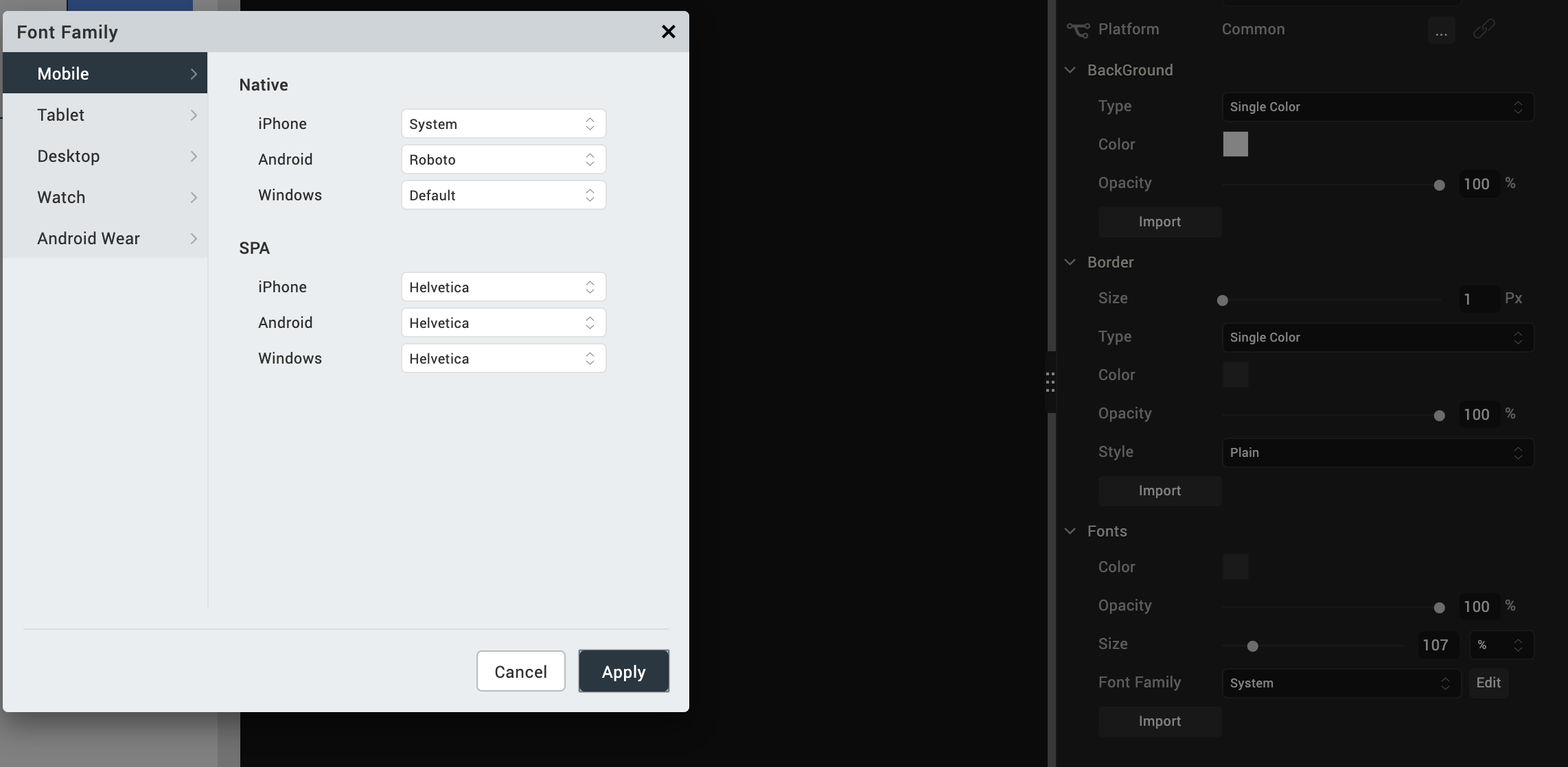

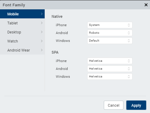

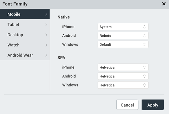

Font Family: Click the Edit button of the Font Family property to open the Font Names window.
Here, you can select the fonts for individual platforms for both Mobile and Tables
Font Family: You can either assign a default font family for all platforms by selecting a font from the Font Family drop-down list, or assign a font by platform using the Edit button. In assigning fonts by platform, you can use either of the two following methods:
Assign a font to a single platform Assign a font to multiple platforms To assign a font to an individual platform, do the following: To assign a font to multiple platforms, do the following:
On the Iris Canvas, from the Platform drop-down list, select a platform. From the widget Properties pane, click Skin tab.From the Font Family drop-down list, select a font.Save the project. Repeat the above steps for assigning fonts to other platforms. |
Click Edit, next to the Font Family drop-down list. On the Mobile tab, select the required font for each of the native and SPA platforms. On the Tablet tab, select the required font for each of the native and SPA platforms. On the Desktop tab, select the required font for Web and Windows platforms. Click Apply.
Weight: Select whether text on the widget should be normal or bold.
- Style: Select whether text on the widget should be underlined or italicized.
Set the Skin Font Shadow
Configure the text properties of a skin using Distance X, Distance Y, Blur, and Color properties -
Note: The Text Shadow feature is available only for specific widgets such as Button, Label, and TextBox2.
You can modify the following text shadow properties of a widget:
- DistX: Denotes the horizontal shadow distance away from the widget text.
- A positive value places the text shadow to the right of the text.
- A negative value places the text shadow to the left of the text.
- DistY: Denotes the vertical shadow distance away from the widget.
- A positive value places the text shadow below the text.
- A negative value places the text shadow above the text.
- Blur: Denotes the shadow blur of the widget and allows you to soften text shadow.
- Color: Denotes the color of the text shadow. You can select a text shadow color by clicking the Color Picker.

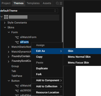

Edit a Skin
To edit a skin you created in Volt MX Iris, do the following:
Right-click the skin, and select Edit As.
Select an option from the menu. The options are:
- Skin: Skin of the widget when it is not focused.
- Menu Focus Skin: Skin of the widget when it is focused by the user.
- Configure the skin as required.
- Save the skin. After you save the skin, a new skin file is created in Project Explorer. You can use this skin for widgets in your application.
Apply a Skin
To apply a skin to a widget, do the following:
- Select a widget from the Iris Canvas.
- In the Properties pane, click the Skins tab.
- Select the state of the widget that you want the skin to apply to, such as Normal or Focus.
- Click the Search icon to the right of the Name text box. The drop-down list that appears lists all the available skins. To filter out unwanted skins from the list, begin typing the name of the skin you want.
- From the drop-down list of skins, select the skin you want to use.
- Go to Skins tab.
- Navigate to your widget of choice.
- Right-click and select Assign To > Skin / Focus Skin. If you select Skin, the skin will be applied to the normal state of the widget. If you select Focus Skin, the skin will be applied to the focused state of the widget.
Reuse Skins
Skins can be used to display different views of widgets in different platforms.
- Import: Allows you to import a CSS file to be used as skin. This action can be performed using CSS Hat plug-in and Adobe Photoshop. You can find the list of CSS elements supported for import here.
- Copy: Allows you to copy the current skin of a widget to a clipboard.
- Paste: Allows you to paste the copied skin to a selected widget.
Note: Copying and pasting a skin creates another version of the original skin. The pasted skin becomes an independent skin. Any changes made to the original skin do not affect the pasted skin.
Note: The paste function can be applied across the widget states. For example, a Normal state skin of a Button Widget can be copied and pasted to the Focus skin state of the Button Widget.
Assign: Allows you to assign the copied skin to a widget.
- Duplicate: Allows you to duplicate the current skin.

Fork a Skin
Through forking you can provide different values for the same skin across different platforms. However, only certain widget properties can be forked. You can identify if a property can be forked by the presence of a wishbone-shaped icon to the left of the property's name. Two types of forking are available:
Simple Forking. Fork one platform at a time.
Complex Forking. Forks multiple platforms of your choosing at the same time.
You can configure a skin and make it common to all platforms or apply it to a particular platform using the fork option in the Properties > Skins tab.
To fork a skin, do the following:
From the Application Canvas, select the platform for which you want to fork.
In the Properties Editor on the Skin tab, in the General section, click the Fork icon to fork the skin for a selected platform. If the option is selected, the fork icon turns blue. The platform for which the skin is forked also appears at the platform.
Note: You can also go to the Skins tab in Project Explorer, and right-click a skin to fork the skin.
- Click the lock icon to lock a skin. If you lock a skin, changes made to a widget's skin in one platform are applied to the remaining platforms.
Click the ellipsis icon. The Fork Skin dialog appears.
Note: For widgets like Calendar, which has the View Type property while forking. You can set the View Type property to different values.
Select the platforms to fork and click OK. The skin will be forked for selected platforms.
Important Considerations in Forking
- Widgets that have background type as Multi-Step Gradient are by default forked (for example, Button and Phone Widgets).
- When you fork and lock a widget skin, changes made to a widget's skin in one platform get applied to the remaining platforms, unless you specifically, unlock a platform.
- To provide a unique skin for a platform, you apply fork and unlock properties for that platform.
- By default all the widgets (except widgets that have background type as Multi-Step Gradient), will have a Common skin. Changes made to the Common skin will be applied across the platforms.
You can select the platforms to be forked by clicking the ellipsis button. From the Fork Skin dialog, select the desired platforms to be forked.
Delete a Skin
To delete a skin from the project library in Volt MX Iris, do the following:
- Go to the Skins tab in the Project Explorer.
- Select the widget that has the skin you want to delete.
Right-click the skin, and then click Delete.
Select Yes in the confirmation window that appears. The selected skin is deleted.
Note: If a skin is deleted, widgets attached to the skin revert to the default skins.
