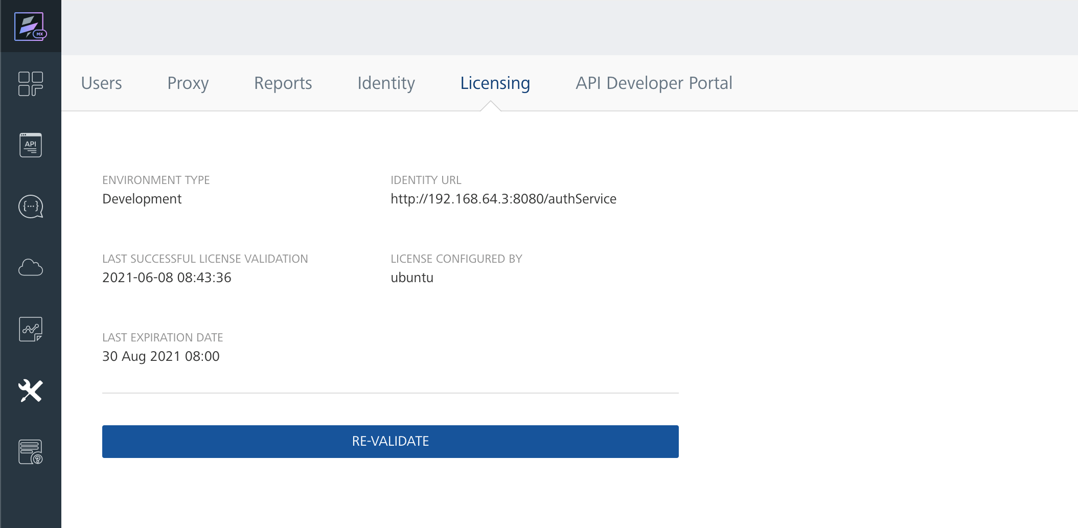

  • In Settings, on the Licensing tab, click RE-VALIDATE. licensing tab
  • When revalidation is complete, the updated license information appears on the Licensing tab. Note: If revalidation fails, the license configurator dialog appears, so you can supply the correct license information.

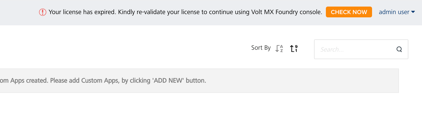

  • If your license expires, a license notification appears at the top of the console. Click CHECK NOW. expired license notification
  • You are redirected to the Licensing tab, which displays the license information. Click RE-VALIDATE. licensing tab

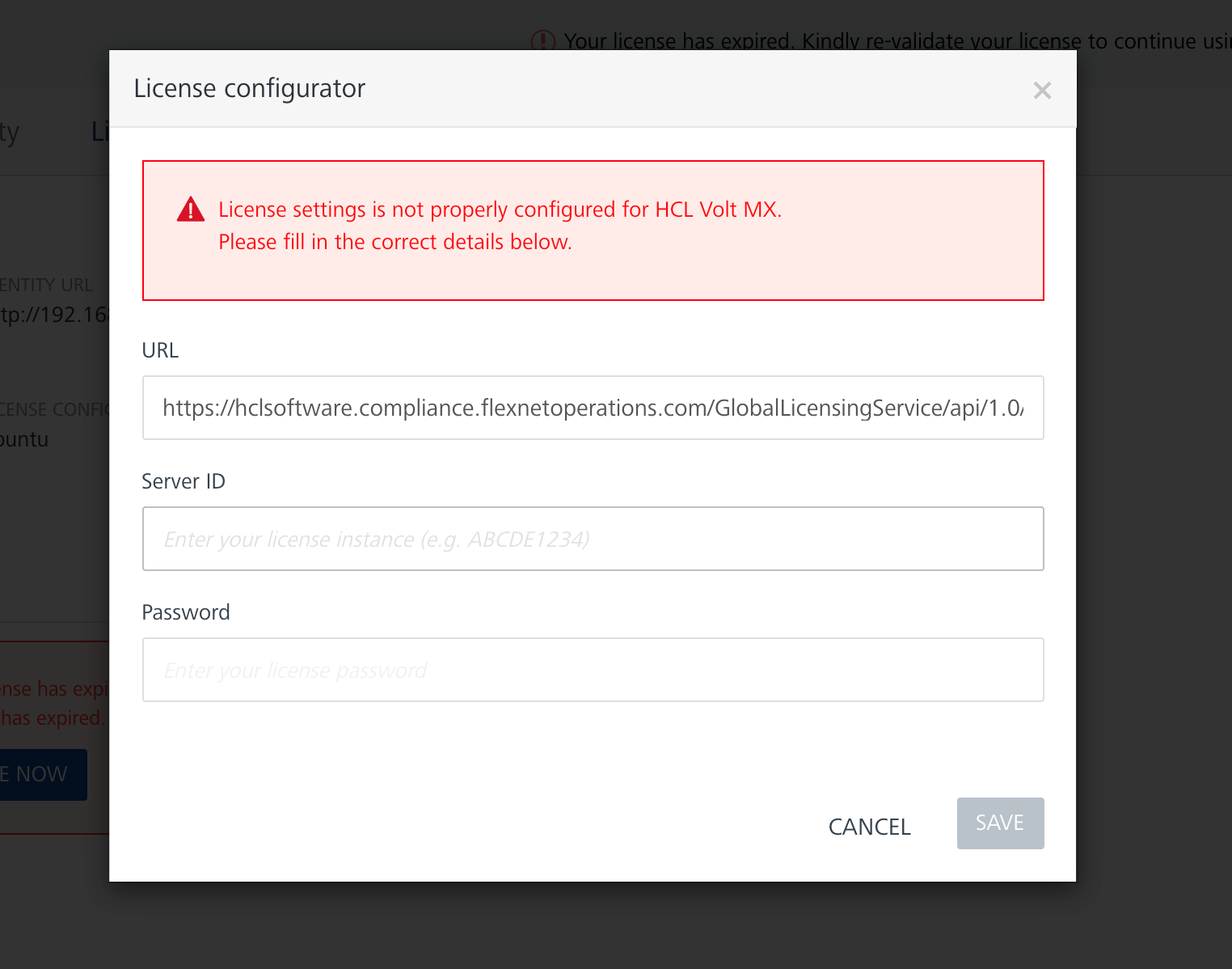

  • The license configurator dialog prompts you to input a valid license Server ID. If necessary, contact HCL Software Customer Support for license renewal. After saving the configuration, wait for a few seconds for the license to revalidate. licensing tab

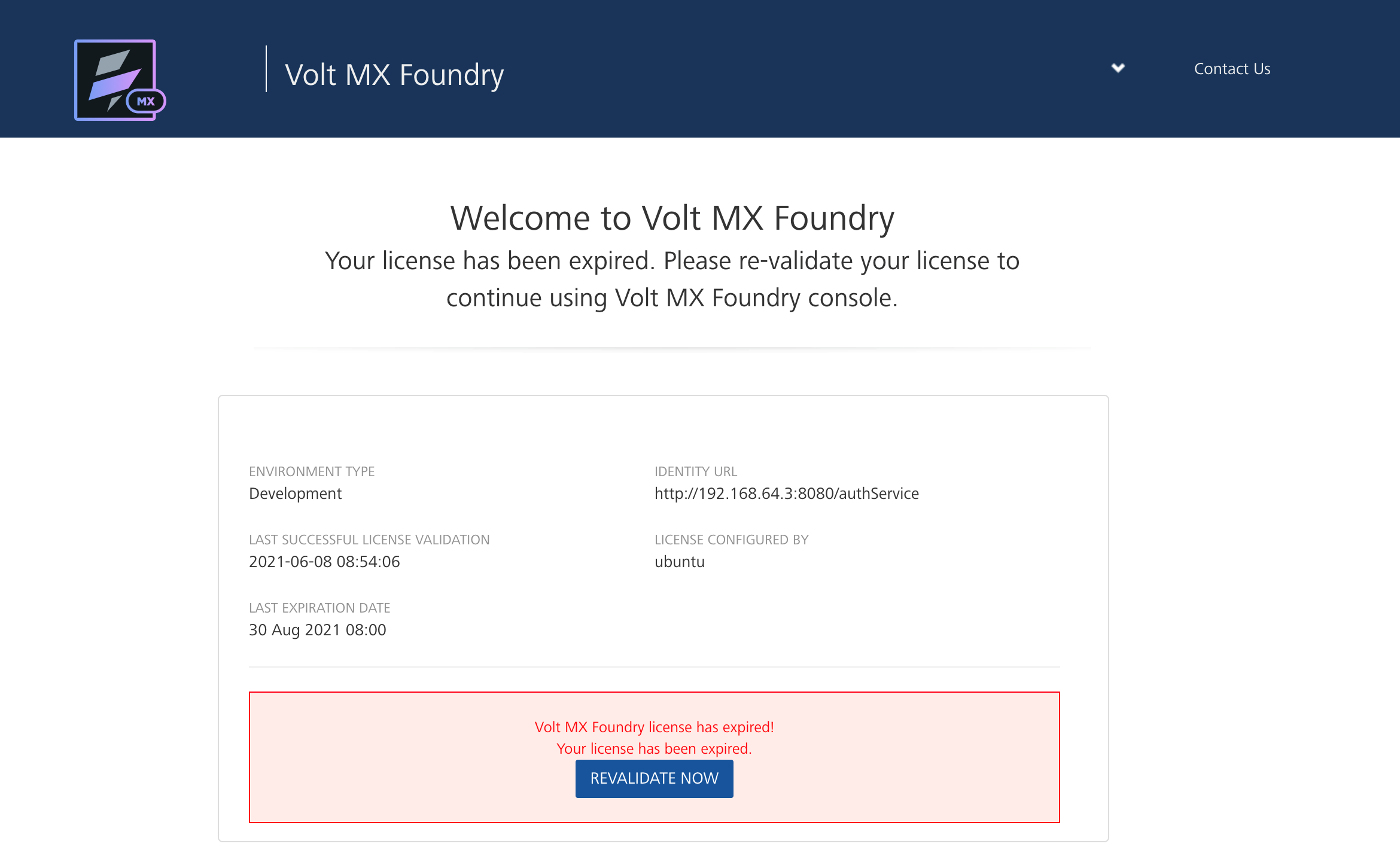

If your license has been expired 30 days or more, the Foundry console blocks you from accessing the application and displays the Licensing tab. Click REVALIDATE NOW. 30 days expired licensing tab
In the license configurator dialog, enter a valid license Server ID. If necessary, contact HCL Software Customer Support for license renewal. After saving the license configuration, wait for a few seconds for the license to revalidate.
After successful license revalidation, you are redirected to the re-enabled console dashboard.
