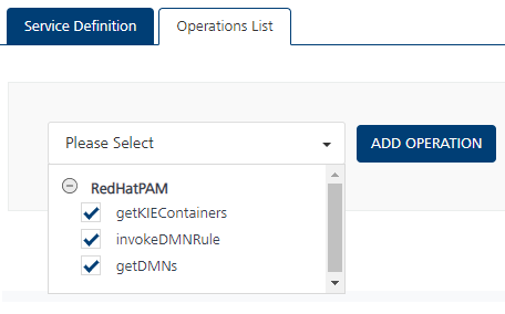

    Click Add Operation to add a new operation or from the tree in the left pane, click Add > Add New Operation.
  • From the ADD OPERATION list, expand the RedHatPAM and select the check boxes for the available operations.
  • Click ADD OPERATION. The new operations are created under Configured Operations section.

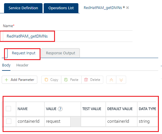

    DMNs_getDMNs containerId
    Response The Response of the getDMNs operation contains the configuration parameters such as modelNameSpace and modelName, which are needed to invoke the invokeDMNRule operation.

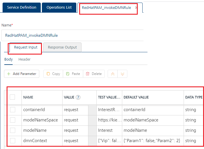

    DMNs_invokeDMNRule containerId
    modelNameSpace
    modelName
    dmnContext
      To invoke invokeDMNRule operation, you need to provide the dmnContext as a JSON payload. For example:
    Response The Response of the invokeDMNRule operation contains the Decision Model and Notation (DMN) evaluation result.
