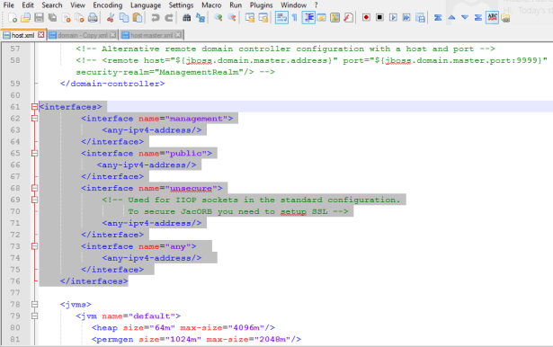

For JBoss domain mode installation, configure the following interface address.
- Go to
<JBOSS EAP dir>/domain/configuration/host.xml - In place of existing
interfacesxml tag, replace the default content with below details:
<interfaces>
<interface name="management">
<any-ipv4-address/>
</interface>
<interface name="public">
<any-ipv4-address/\>
</interface>
<interface name="unsecure">
<!-- Used for IIOP sockets in the standard configuration.
To secure JacORB, you need to set up SSL -->
<any-ipv4-address/>
</interface>
<interface name="any">
<any-ipv4-address/>
</interface>
</interfaces>
