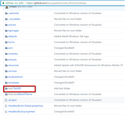

- Make sure that the Iris project contains the Appium test files at the following location:
<Project-Root>/test/TestNG/ - Make sure that you configure a device pool before you test the application

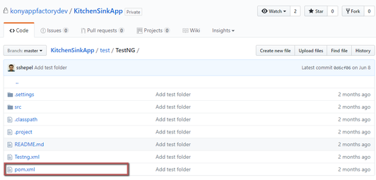

Tests must be compiled by using a Maven configuration file (pom.xml) that is available in the Tests root folder (
<Project-Root>/test/TestNG)

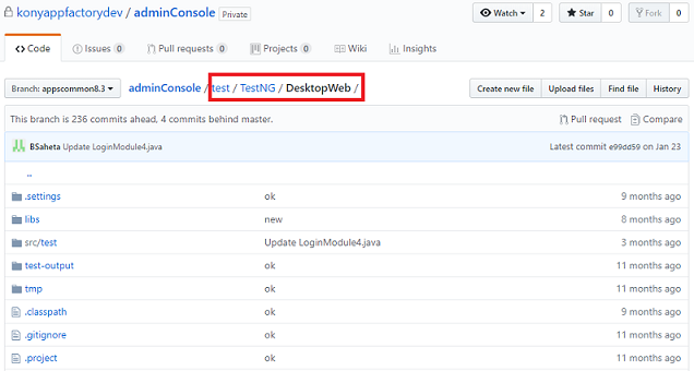

- Make sure that the Iris project contains the Selenium test files at the following location:
<Project-Root>/test/TestNG/DesktopWeb/

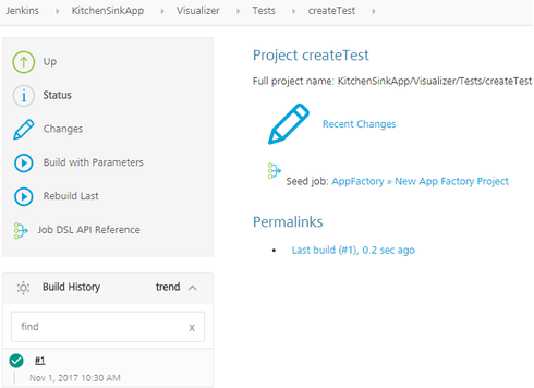

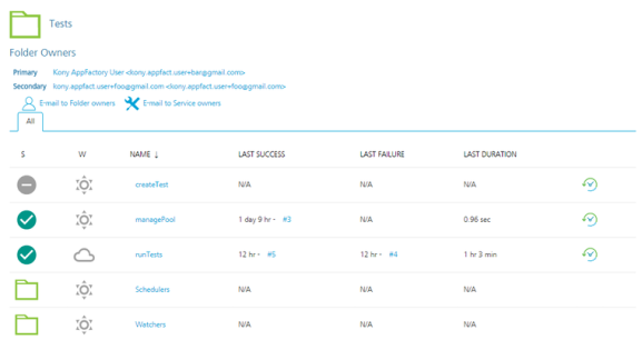

- From the Iris folder of your project, navigate to the Tests sub-folder.

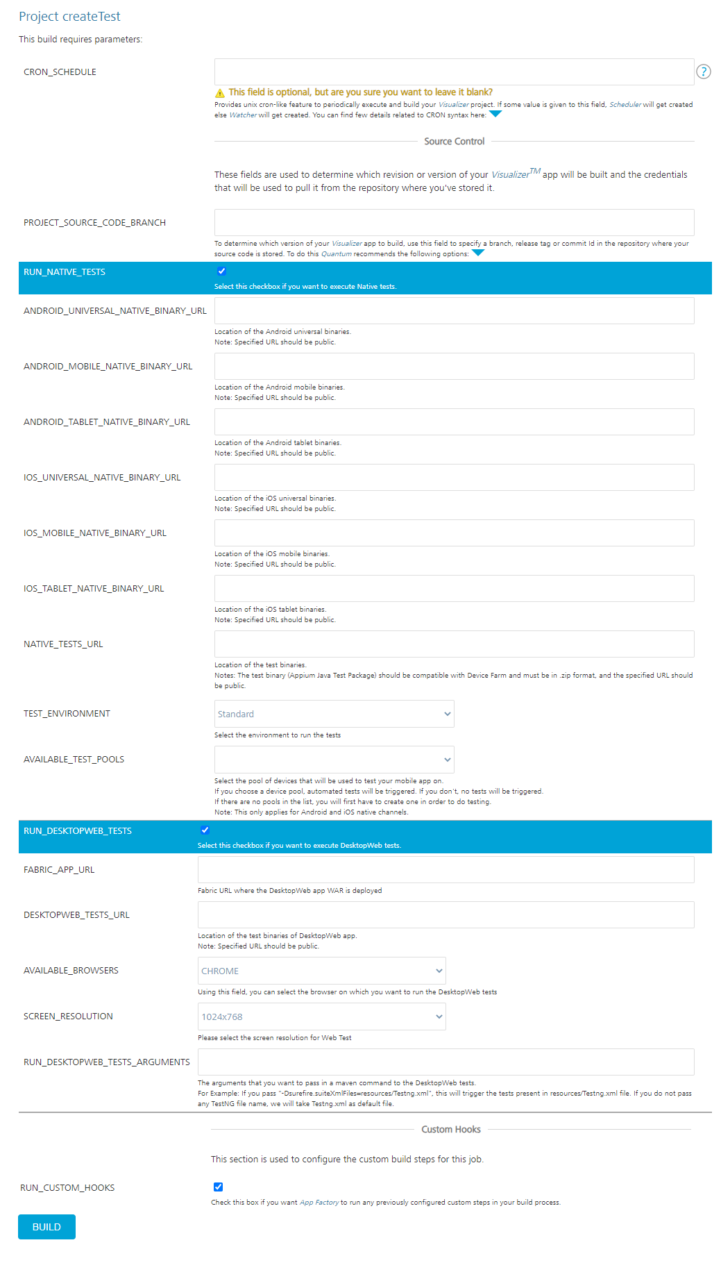

- For the runTest job, click the Build with Parameters icon on the right side of the row.
Alternatively, select the runTest job, and then from the left panel of the details page, select Build with Parameters. - Configure the build parameters for the runTest job. For more information about the parameters, refer to the following sections.
Source Control
<table style="width: 80%;mc-table-style: url('Resources/TableStyles/Basic.css');" class="TableStyle-Basic" cellspacing="0"><colgroup><col class="TableStyle-Basic-Column-Column1" style="width: 30%;"><col class="TableStyle-Basic-Column-Column1" style="width: 50%;"></colgroup><tbody><tr class="TableStyle-Basic-Body-Body1"><th class="TableStyle-Basic-BodyE-Column1-Body1">Parameter</th><th class="TableStyle-Basic-BodyD-Column1-Body1">Description</th></tr><tr class="TableStyle-Basic-Body-Body1"><td class="TableStyle-Basic-BodyE-Column1-Body1">PROJECT_SOURCE_CODE_BRANCH</td><td class="TableStyle-Basic-BodyD-Column1-Body1">Specifies the branch, release tag, or the commit ID of the repository that contains the test files.The tests must be placed at the following location:<code class="file_names"><Repository-Root>/<Project-Root>/test/testNG/</code>The <b><Repository_Root></b> and <b><Project-Root></b> must be configured while <a href="Setup.html#Iris" target="_blank">creating the Iris project in App Factory</a>.</td></tr><tr class="TableStyle-Basic-Body-Body1"><td class="TableStyle-Basic-BodyE-Column1-Body1">RUN_NATIVE_TESTS</td><td class="TableStyle-Basic-BodyD-Column1-Body1">Specifies whether App Factory must run tests for the Native platform.If you enable this parameter, the console displays additional parameters for Native tests. For more information, refer to <a href="#Build_Native" class="selected">Native build parameters</a>.</td></tr><tr class="TableStyle-Basic-Body-Body1"><td class="TableStyle-Basic-BodyB-Column1-Body1">RUN_DESKTOPWEB_TESTS</td><td class="TableStyle-Basic-BodyA-Column1-Body1">Specifies whether App Factory must run tests for the Desktop Web platform.If you enable this parameter, the console displays additional parameters for Desktop Web tests. For more information, refer to <a href="#Desktop_Build" class="selected">Desktop Web build parameters</a>.</td></tr></tbody></table>
<table style="mc-table-style: url('Resources/TableStyles/Basic.css');width: 90%;" class="TableStyle-Basic" cellspacing="0"><colgroup><col class="TableStyle-Basic-Column-Column1" style="width: 35%;"><col class="TableStyle-Basic-Column-Column1" style="width: 55%;"></colgroup><tbody><tr class="TableStyle-Basic-Body-Body1"><th class="TableStyle-Basic-BodyE-Column1-Body1">Parameter</th><th class="TableStyle-Basic-BodyD-Column1-Body1">Description</th></tr><tr class="TableStyle-Basic-Body-Body1"><td class="TableStyle-Basic-BodyE-Column1-Body1">ANDROID_UNIVERSAL_NATIVE_BINARY_URL</td><td class="TableStyle-Basic-BodyD-Column1-Body1">Specifies the URL of the Android universal binaries that are generated by a build job or generated locally.</td></tr><tr class="TableStyle-Basic-Body-Body1"><td class="TableStyle-Basic-BodyE-Column1-Body1">ANDROID_MOBILE_NATIVE_BINARY_URL</td><td class="TableStyle-Basic-BodyD-Column1-Body1">Specifies the URL of the Android Mobile binary that is generated by a build job or generated locally.</td></tr><tr class="TableStyle-Basic-Body-Body1"><td class="TableStyle-Basic-BodyE-Column1-Body1">ANDROID_TABLET_NATIVE_BINARY_URL</td><td class="TableStyle-Basic-BodyD-Column1-Body1">Specifies the URL of the Android Tablet binary that is generated by a build job or generated locally.</td></tr><tr class="TableStyle-Basic-Body-Body1"><td class="TableStyle-Basic-BodyE-Column1-Body1">IOS_UNIVERSAL_NATIVE_BINARY_URL</td><td class="TableStyle-Basic-BodyD-Column1-Body1">Specifies the URL of the iOS universal binaries that are generated by a build job or generated locally.</td></tr><tr class="TableStyle-Basic-Body-Body1"><td class="TableStyle-Basic-BodyE-Column1-Body1">IOS_MOBILE_NATIVE_BINARY_URL</td><td class="TableStyle-Basic-BodyD-Column1-Body1">Specifies the URL of the iPhone binary that is generated by a build job or generated locally.</td></tr><tr class="TableStyle-Basic-Body-Body1"><td class="TableStyle-Basic-BodyE-Column1-Body1">IOS_TABLET_NATIVE_BINARY_URL</td><td class="TableStyle-Basic-BodyD-Column1-Body1">Specifies the URL of the iPad binary that is generated by a build job or generated locally.</td></tr><tr class="TableStyle-Basic-Body-Body1"><td class="TableStyle-Basic-BodyE-Column1-Body1">NATIVE_TESTS_URL</td><td class="TableStyle-Basic-BodyD-Column1-Body1">Specifies the URL of the binaries for the compiled test project. If you provide Git parameters, you can skip this parameter.</td></tr><tr class="TableStyle-Basic-Body-Body1"><td class="TableStyle-Basic-BodyE-Column1-Body1">TEST_ENVIRONMENT</td><td class="TableStyle-Basic-BodyD-Column1-Body1">Specifies the environment on which the Device Farm runs the test. You can select a Standard Test Environment, or select a Custom Test Environment.For more information, refer to <a href="#Native" class="selected">Native Testing Environments</a>.If you select a Custom Test Environment, the console displays additional parameters. For more information, refer to Custom Test Environment parameters.</td></tr><tr class="TableStyle-Basic-Body-Body1"><td class="TableStyle-Basic-BodyB-Column1-Body1">AVAILABLE_TEST_POOLS</td><td class="TableStyle-Basic-BodyA-Column1-Body1">Specifies the device pool that must be used for the tests. If a device pool is empty, the build fails.For more information, refer to <a href="Configuring_Device_Pools.html" target="_blank">Configuring Device Pools</a>.</td></tr></tbody></table>
**Custom Test Environment parameters**
<table style="mc-table-style: url('Resources/TableStyles/Basic.css');width: 90%;" class="TableStyle-Basic" cellspacing="0"><colgroup><col class="TableStyle-Basic-Column-Column1" style="width: 35%;"><col class="TableStyle-Basic-Column-Column1" style="width: 55%;"></colgroup><tbody><tr class="TableStyle-Basic-Body-Body1"><th class="TableStyle-Basic-BodyE-Column1-Body1">Parameter</th><th class="TableStyle-Basic-BodyD-Column1-Body1">Description</th></tr><tr class="TableStyle-Basic-Body-Body1"><td class="TableStyle-Basic-BodyE-Column1-Body1">APPIUM_VERSION</td><td class="TableStyle-Basic-BodyD-Column1-Body1">Specifies the Appium version that is used to run the tests.</td></tr><tr class="TableStyle-Basic-Body-Body1"><td class="TableStyle-Basic-BodyB-Column1-Body1">TESTNG_FILES</td><td class="TableStyle-Basic-BodyA-Column1-Body1">Specifies the relative path of the TestNG.xml file in the test jar file, for example: <code class="file_names" style="font-size: 11pt;">appfactory/Testng.xml</code>.If the path is not specified, the root of the test jar file is taken as the default path.You can specify multiple file paths by using comma separated path values. For example:<code class="codefirst">voltmx/Testng.xml,voltmx/appfactory/Testng.xml,testng.xml</code><span class="autonumber"><span><b><i><span style="color: #0a9c4a;" class="mcFormatColor">Note: </span></i></b></span></span>If the specified TestNG file is not found in the source, the tests run independently similar to Standard Test Environment.</td></tr></tbody></table>
<table style="mc-table-style: url('Resources/TableStyles/Basic.css');width: 90%;" class="TableStyle-Basic" cellspacing="0"><colgroup><col class="TableStyle-Basic-Column-Column1" style="width: 35%;"><col class="TableStyle-Basic-Column-Column1" style="width: 55%;"></colgroup><tbody><tr class="TableStyle-Basic-Body-Body1"><th class="TableStyle-Basic-BodyE-Column1-Body1">Parameter</th><th class="TableStyle-Basic-BodyD-Column1-Body1">Description</th></tr><tr class="TableStyle-Basic-Body-Body1"><td class="TableStyle-Basic-BodyE-Column1-Body1">FOUNDRY_APP_URL</td><td class="TableStyle-Basic-BodyD-Column1-Body1">Specifies the URL of the Foundry app with which the Desktop Web WAR file is published.</td></tr><tr class="TableStyle-Basic-Body-Body1"><td class="TableStyle-Basic-BodyE-Column1-Body1">DESKTOPWEB_TESTS_URL</td><td class="TableStyle-Basic-BodyD-Column1-Body1">Specifies the URL of the Desktop Web binary that is generated by a build job or generated locally.</td></tr><tr class="TableStyle-Basic-Body-Body1"><td class="TableStyle-Basic-BodyE-Column1-Body1">AVAILABLE_BROWSERS</td><td class="TableStyle-Basic-BodyD-Column1-Body1">Specifies the browser on which you want to run the Desktop Web tests.</td></tr><tr class="TableStyle-Basic-Body-Body1"><td class="TableStyle-Basic-BodyE-Column1-Body1">SCREEN_RESOLUTIONS</td><td class="TableStyle-Basic-BodyD-Column1-Body1">Specifies the resolution at which the browser must launch and run the tests.</td></tr><tr class="TableStyle-Basic-Body-Body1"><td class="TableStyle-Basic-BodyB-Column1-Body1">RUN_DESKTOPWEB_TESTS_ARGUMENTS</td><td class="TableStyle-Basic-BodyA-Column1-Body1">Specifies additional arguments (parameters) that must be passed in the Maven command for the Desktop Web tests.For Example: If you pass <span style="font-family: monospace;">-Dsurefire.suiteXmlFiles=resources/Testng.xml</span>, the argument triggers the tests from the <span style="font-family: monospace;">resources/Testng.xml</span> file. If you do not pass the argument, <span style="font-family: monospace;">Testng.xml</span> is selected as a default file.</td></tr></tbody></table>
Custom Hooks
<table style="mc-table-style: url('Resources/TableStyles/Basic.css');width: 90%;" class="TableStyle-Basic" cellspacing="0"><colgroup><col class="TableStyle-Basic-Column-Column1" style="width: 35%;"><col class="TableStyle-Basic-Column-Column1" style="width: 55%;"></colgroup><tbody><tr class="TableStyle-Basic-Body-Body1"><th class="TableStyle-Basic-BodyE-Column1-Body1">Parameter</th><th class="TableStyle-Basic-BodyD-Column1-Body1">Description</th></tr><tr class="TableStyle-Basic-Body-Body1"><td class="TableStyle-Basic-BodyB-Column1-Body1">RUN_CUSTOM_HOOKS</td><td class="TableStyle-Basic-BodyA-Column1-Body1">Specifies whether Custom Hooks must be run in the after the tests are executed (the Post-Test stage). For more information, refer to <a href="CustomHooks.html" target="_blank">Custom Hooks</a>.</td></tr></tbody></table>

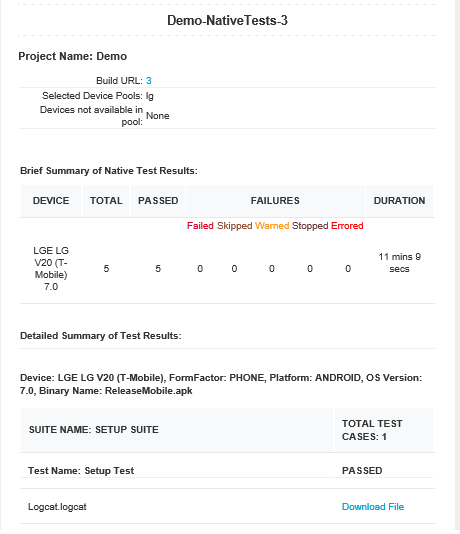

Native Test Results
When the project test build is complete and the test results are published at S3, e-mail notifications are sent to recipients:
On unsuccessful build for the tests run, the following e-mail is sent to the recipients:
In the final stage, the consolidated test run status is notified via e-mail. Refer the following screenshots for the sample email for consolidated status.
Sample email for Native tests
To download test data fetched from AWS Device Farm, click Download File link. Data is stored at S3 and available for review without time limitations.

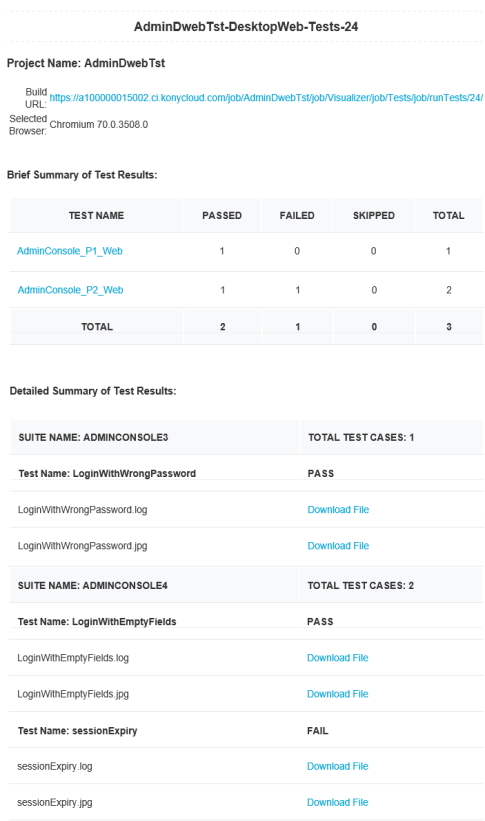

Desktop Web Test Results
Sample email for DesktopWeb tests
The summary of the test results are shown based on the tests executed on specified browser that includes passed, failed, skipped. Usually the tests are skipped when the driver initialization fails.
You can click the respective links in Brief Summary table to view the test summary.
To download the log files for each test case, click the respective Download File link. If you have any test failures, you can use these files to debug them.

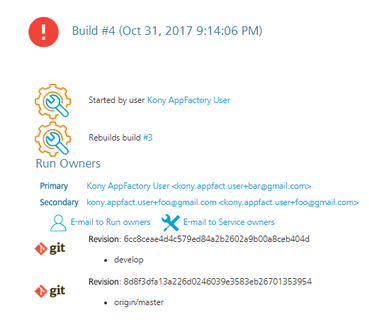

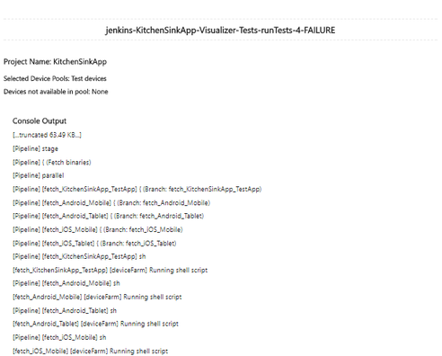

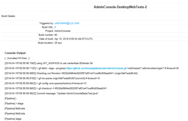

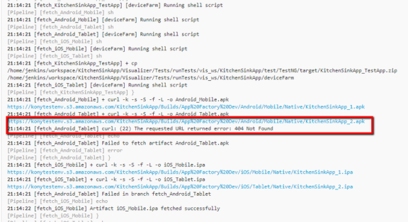

The builds that failed during the test can be tracked for the issues that caused the failure. For example, consider build #4 from the following screenshots of runTests job. To troubleshoot the issue, follow these steps.
- From your project folder, navigate to Iris > Tests.
- Select the runTests job, and then find the failed build.
For example, find and click the link for build #4.

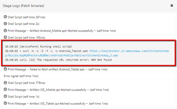

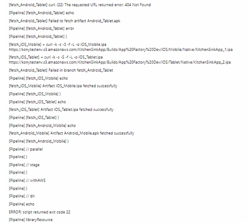

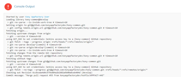

- From the details page of the failed build, select the Console Output on the left panel. The Console Output Log opens in the right pane.
- Scroll to find errors in the log that caused the build to fail. For example, you can trace an error that is related to invalid Android Tablet URL.
- Check if the ANDROID_TABLET_NATIVE_BINARY_URL parameter is valid.

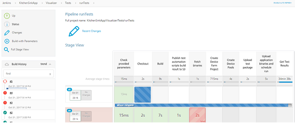

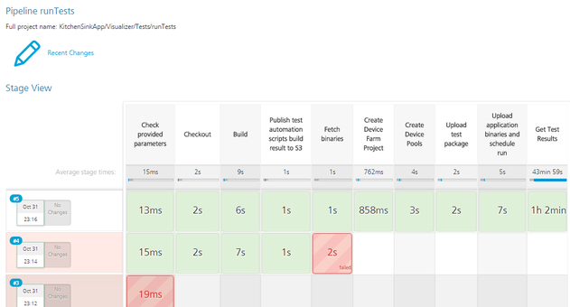

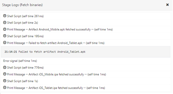

Alternatively you can troubleshoot the issue from the stages of Manual Testing.
To troubleshoot the issue from the Stage View, follow these steps:
- From the Stage View, point to the failed stage, and then click Logs.
- From log messages in the Stage Logs window, identify the error message that corresponds to the failure of the build.
- Check whether the ANDROID_TABLET_NATIVE_BINARY_URL parameter is valid.

- Go to Tests folder under project's root folder.
- Click on createTest job.
- Provide all required parameters (they are the same as in "Facade" job).

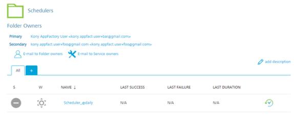

Important: Please note, that there is one additional parameter, which is called "CRON_SCHEDULE". If "CRON_SCHEDULE" parameter is given, then a cron-triggered job is created and stored in "Schedulers" sub-folder. If the parameter is not provided, a scm-triggered job is created and stored in "Watchers" sub-folder.
- Check that the createTest job is complete.

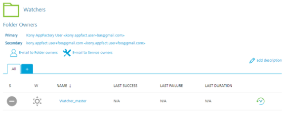

Important: Every Scheduler that is created, will have cron string in job's name to simplify the job search. Refer the image below.
Important: Every Watcher that is created contains the branch name in the job name to simplify job search.
