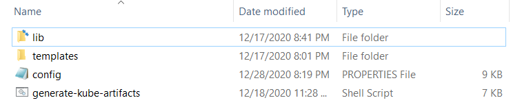

  1. Extract the FoundryKube.zip file. The OpenShift Foundry artifacts generation zip is organized as follows:
    • lib: Contains dependent jars and helper bash functions
    • templates: Contains the following files
      • foundry-app-tmpl.yml: YAML template for Foundry deployments
      • foundry-db-tmpl.yml: YAML template for Foundry Database schema creation
      • foundry-services.yml: YAML template for Foundry services
    • config.properties: Contains inputs that you must configure for the installation
    • generate-kube-artifacts.sh: A user script that is used to generate required artifacts
    As a result of executing the generate-kube-artifacts.sh script, the artifacts folder is created containing YAML configuration files. The YAML configuration files are generated based on the config.properties file, and they must be applied later to deploy Volt MX Foundry on the OpenShift cluster.

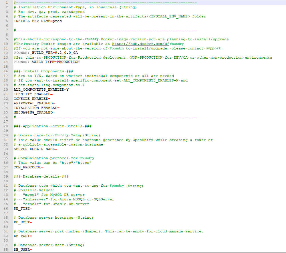

  2. Update the config.properties file with relevant information.
For more information about the properties, refer to the following section.
config.properties
  1. INSTALL_ENV_NAME: The install environment name must be a in string value in lowercase. For example: dev, qa, prod, or eastusprod.

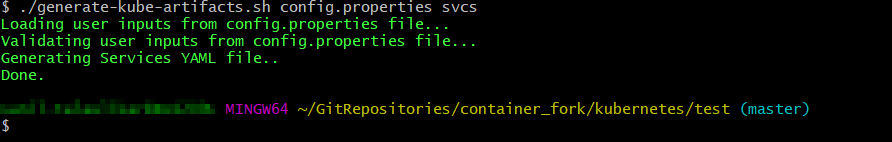

  2. Generate the Foundry services by running the following command:
    ./generate-kube-artifacts.sh config.properties svcs
    To generate the services configuration, you only need to fill the INSTALL_ENV_NAME property and the ## Install Components ### section in the config.properties file.

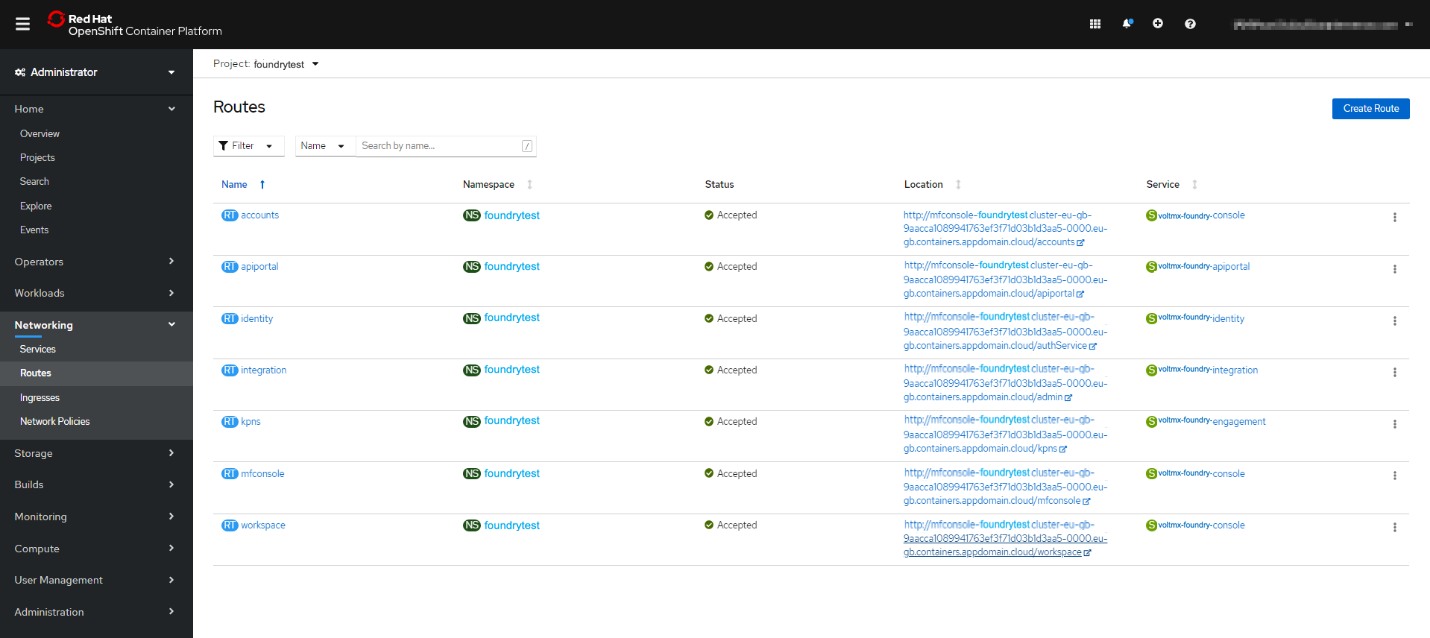

  4. Follow either of the following steps to expose Foundry publicly.
    • For development or proof of concept, using HTTP (non-SSL) routes and OpenShift generated hostnames is a quick way to get started. Create the routes from the OpenShift console or by running the following command:
      oc expose service/<foundry-service> --path=<context_path> --name=<route_name>
      For <foundry-service> and <context-path>, refer to Context paths for Foundry components. The <foundry-service> is one of the Foundry services that were created earlier.
      Executing the oc expose service command assigns a unique OpenShift generated host name to the route that is created. The assigned host name can be identified by executing the following command:
      oc describe route <foundry-route>

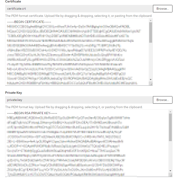

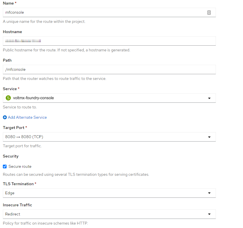

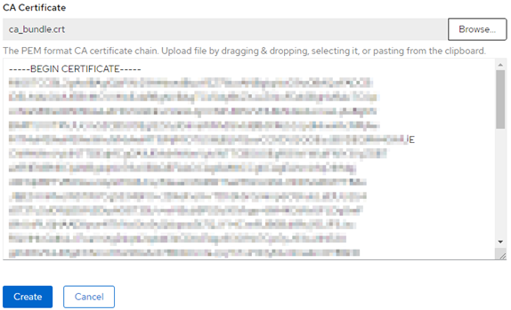

    • For production, Volt MX recommends that you use a custom domain name and terminate your SSL connection at the public load balancer. You need to obtain a custom domain name from a DNS provider, and SSL certificate and keys from a certificate authority. For more information, refer to Exposing apps with routes in OpenShift 4.
      Note: The route types Reencrypt and Passthrough are not supported.
      For a sample configuration, refer to the following screenshot.

To configure the passthrough, you need to create a secure route for the Foundry component. To do so, follow these steps:
  1. On the Create Route page, configure details for the Foundry component.
    Note: The details in the screenshot are specific to the API Portal component and use a specific domain. Make sure that you change the details for other routes. For more information, refer to Context paths and Service Names for Fabric components.
  2. Under Security, select the Secure Route check box.
  3. From the TLS termination list, select Passthrough.
  4. Provide the required values in the Application Server Details section of the config.properties file.
Context paths and Service Names for Foundry components
  • Make sure that you use the same host name for all the Foundry routes that you plan to create.
  • The Foundry components for accounts, mfconsole, and workspace share the same deployment and service. Therefore, while creating the ingress objects for accounts, mfconsole, and workspace, the paths are mapped to the same service: voltmx-foundry-console.
Make sure that the format of the route location is as follows:
<scheme>://<common_domain_name>/<foundry_context_path>
For example, https://voltmx-foundry.domain/mfconsole
Reference table for the mapping of paths and service names:
Foundry Component Foundry Service Name Context Path
mfconsole voltmx-foundry-console /mfconsole
workspace voltmx-foundry-console /workspace
accounts voltmx-foundry-console /accounts
Identity voltmx-foundry-identity /authService
Integration voltmx-foundry-integration /admin
Services voltmx-foundry-integration /services
apps voltmx-foundry-integration /apps
Engagement voltmx-foundry-engagement /kpns
ApiPortal voltmx-foundry-apiportal /apiportal

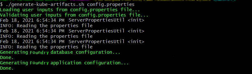

  3. Generate the Foundry application and database configuration files by executing the following command.
    OpenShift_GenerateKubeArtifacts

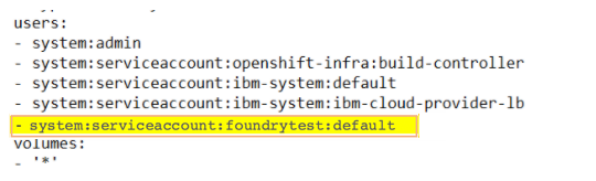

  4. Edit the privileged security context by running the following command, and then add the service account that corresponds to your project.
    oc edit scc privileged
    For example: In the following screenshot, foundrytest is the project and default is the service account that is being used. OpenShift_ServiceAccount
    Note: Adding the service account to the privileged security context is only needed to create the database schema in the following step. After the execution of the Foundry database job is completed, you can remove the service account from the privileged security context.
