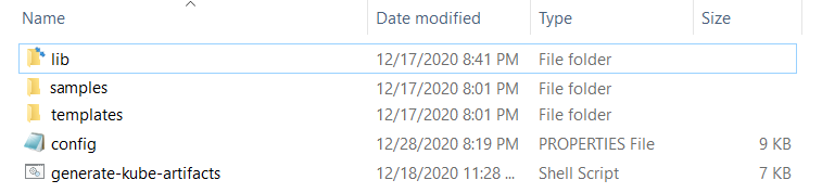

  1. Extract the FoundryKube.zip file. The zip file is organized as follows:
    • lib: Contains dependent jars and helper bash functions
    • samples: Contains sample Foundry deployments
    • templates: Contains the following files
      • foundry-app-tmpl.yml: YAML template for Foundry deployments
      • foundry-db-tmpl.yml: YAML template for Foundry Database schema creation
      • foundry-services.yml: YAML template for Foundry services
      • foundry-ingress.yml: YAML template for Ingress configuration
    • config.properties: Contains inputs that you must configure for the installation
    • generate-kube-artifacts.sh: A user script that is used to generate required artifacts
    As a result of executing the generate-kube-artifacts.sh script, the artifacts folder is created containing YAML configuration files. The YAML configuration files are generated based on the config.properties file, and they must be applied later to deploy Volt MX Foundry on EKS.

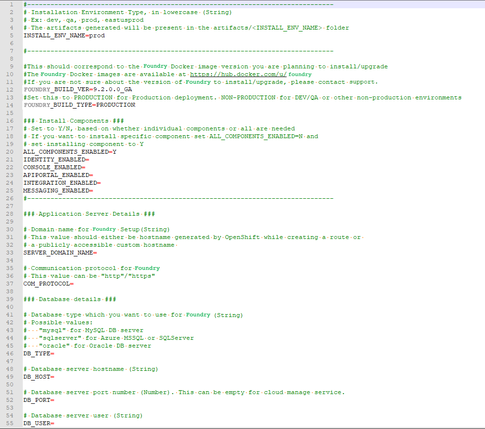

  2. Update the config.properties file with relevant information.
For more information about the properties, refer to the following section.
config.properties
  1. INSTALL_ENV_NAME: The install environment name must be a in string value in lowercase. For example: dev, qa, prod, or eastusprod.
    • HCL_IMAGE_REGISTRY_SECRET:
      Please provide the secret which is configured with hcl harbor username and secret.
      To create the secret from Username and Password, please run the following command then the secret will be created as foundry-image-pull
      Command: kubectl create secret docker-registry foundry-image-pull --docker-server=hclcr.io --docker-username=< your-name > --docker-password=< your-pword > --docker-email=< your-email >
      username: your-email
      password: your-authentication-token
      your-authentication-token - This is the CLI secret found under your User Profile in HCL .
  1. VOLTMX_FOUNDRY_BUILD_VER: The build version of Foundry that you want to install. While upgrading, this specifies the build version to which you want to upgrade.
  2. VOLTMX_FOUNDRY_BUILD_TYPE: The type of Foundry environment that must be created. For production environments, the value must be PRODUCTION. For dev, QA, or other non-production environments, the value must be NON-PRODUCTION.
  3. Install Components: The following properties must be set to either Y (yes) or N (no). Make sure that at least one of the following input properties must be set to Y. If ALL_COMPONENTS_ENABLED is set to Y, the rest of the inputs can be left empty.
    • ALL_COMPONENTS_ENABLED
    • INTEGRATION_ENABLED
    • IDENTITY_ENABLED
    • MESSAGING_ENABLED
    • CONSOLE_ENABLED
    • APIPORTAL_ENABLED
    • Application Server Details
    • SERVER_DOMAIN_NAME: The Domain Name for Volt MX Foundry. This value should be the hostname of the LoadBalancer. For example: abc.companyname (DNS name).
    • COM_PROTOCOL: The communication protocol for Volt MX Foundry. This value can be either http or https.
    • Database Details
    • DB_TYPE - The Database type that is used to host Volt MX Foundry. The possible values are:
      • For MySQL DB server: mysql
      • For Azure MSSQL or SQL Server: sqlserver
      • For Oracle DB server: oracle
    • DB_HOST - The Database Server hostname that is used to connect to the Database Server.
    • DB_PORT– The Port Number that is used to connect to the Database Server. This can be empty for cloud manage service.
    • DB_USER - The Database Username that is used to connect to the Database Server.
    • DB_PASS - The Database Password that is used to connect to the Database Server. Make sure that the value is enclosed in single quotes, for example, 'password'.
    • DB_PASS_SECRET_KEY - This is the decryption key for the database password, which is required only if you are using an encrypted password.
    • DB_PREFIX – This is the Database server prefix for Volt MX Foundry Schemas/Databases.
    • DB_SUFFIX – This is the Database server suffix for Volt MX Foundry Schemas/Databases.
    Note: * Database Prefix and Suffix are optional inputs. * In case of upgrade, ensure that the values of the Database Prefix and Suffix that you provide are the same as you had provided during the initial installation.
    • If DB_TYPE is set as oracle, the following String values must be provided:
      • DB_DATA_TS: Database Data tablespace name.
      • DB_INDEX_TS: Database Index tablespace name.
      • DB_LOB_TS: Database LOB tablespace name.
      • DB_SERVICE: Database service name.
    • USE_EXISTING_DB: If you want to use an existing database from a previous Volt MX Foundry instance, set this property to Y. Otherwise, set the property to N.
      If you want to use an existing database, you must provide the location of the previously installed artifacts (the location must contain the upgrade.properties file).
      For example: PREVIOUS_INSTALL_LOCATION = /C/voltmx-foundry-containers-onprem/kubernetes.
  4. Time Zone: The time zone must be set to maintain consistency between the application server and the database. This section contains the following property:
    • TIME_ZONE: The country code of the time zone from the tz database. For more information, refer to List of tz database time zones. The default value is UTC.

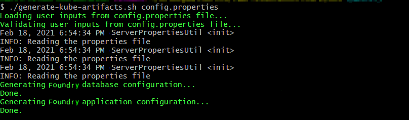

  1. Generate the foundry services by running the following command:
    ./generate-kube-artifacts.sh config.properties
    FoundryOnEKS_Generate

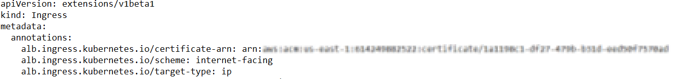

  3. Create the ingress controller and the internet facing application load balancer (ALB). For more information, refer to the following blog post: Kubernetes Ingress with AWS ALB Ingress Controller
    Use the foundry-ingress.yml file, which will map the created services to the load balancer paths.
    The specified process generates a load balancer domain name. Volt MX recommends that you use a custom domain name and terminate your SSL connection at the public load balancer. You need to obtain a custom domain name from a DNS provider and an SSL certificate. To generate a certificate for your custom domain name and the corresponding ARN ](Amazon Resource Name), refer to Requesting a public certificate.
    The generated ARN needs to be updated in the annotations section of the foundry-ingress.yml file as shown in the following screenshot:
    FoundryOnEKS_Ingress

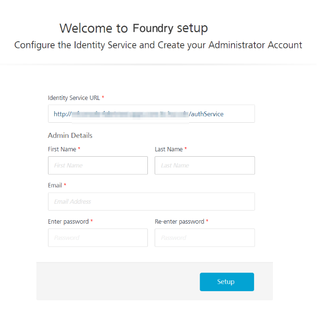

Launch the Foundry Console
  1. After all the Foundry services are up and running, launch the Foundry console by using the following URL.
    <scheme>://<foundry-hostname>/<mfconsole>
The <scheme> is <http> or <https> based on your domain. The <foundry-hostname> is the host name of your publicly accessible Foundry domain. 2. After you launch the Foundry Console, create an administrator account by providing the appropriate details.
After you create an administrator account, you can sign-in to the Foundry Console by using the credentials that you provided.

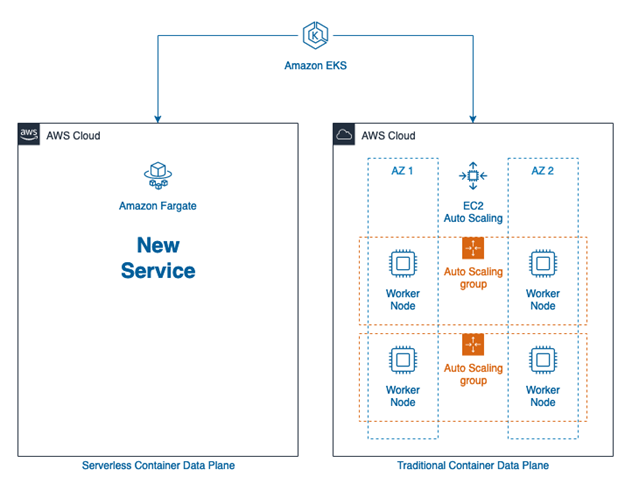

Data Plane Configuration Options
AWS Fargate is a computation engine for containers. With AWS Fargate, you do not require servers, and you can manage and pay for resources based on the number of applications. As all the apps are isolated in Fargate, you also get improved security.
With Amazon EKS, you can create a data plane that consists of a Fargate profile, or a combination of both EC2 instances and a Fargate profile as shown in the following diagram:
For the advantages and disadvantages of the various data plane options, refer to the following table:
Data Plane Architecture Advantages Disadvantages
Managed EC2
  • Better control and visibility into the infrastructure that is being used.
  • Allows Auto-Scaling, which needs to be configured.
  • You need to manage both Infrastructure and applications.
  • Node capacity can lie unused, that is, you are responsible to pack the maximum number of containers on the node.
AWS Fargate
  • Less Complexity. You can focus on deploying and managing applications rather than managing infrastructure.
  • Security. You are responsible only for application-level security.
  • Scaling: Auto-Scaling. You don't need to set up and scale the cluster capacity. The clusters can handle sudden spikes in traffic very well.
  • Lower Costs. You are charged for the duration of container workload usage and not for the duration for which the VM instance is running.
  • Some features of Kubernetes, such as Daemon Sets and hostPath volumes, are not available.
Mixed Mode
  • In case you have acquired EC2 instances at a reasonable cost (Spot or Reserved), you can run the fixed component of the workload on EC2 and the variable component of the workload on Fargate.
  • Additional planning is required to decide how the workload must be split between managed EC2 and Fargate
  • Additional manual configuration changes are required.
The choice of Managed EC2, Fargate, or Mixed Mode depends on what works best based on the advantages and disadvantages that are highlighted in the table. For more information, refer to the Amazon documentation, especially the section on Fargate Pricing.

  3. The generated Foundry artifact YAML files need to be edited to specify the namespace on which the deployment must occur.
  4. An Ingress object from one namespace cannot communicate with services in another namespace. To work around this issue, you need to create ingress objects that correspond to the services that are deployed in the namespace. The alb.ingress.kubernetes.io/group.name annotation can be used to group both ingress objects together and ensure that a single ALB is provisioned by Amazon.
  5. The foundry-common-secrets need to be duplicated in both namespaces so that it can be accessed by the deployments in both namespaces.
Note: You can refer to the Samples/mixedDataPlane folder in the FoundryKube.zip file for a sample configuration where the Identity and Integration components are deployed to the foundry-runtime namespace in a Fargate data plane; and the rest of the components (Console, API Portal, and Engagement) are deployed in the EC2 managed data plane.
