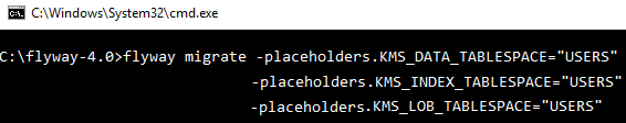

  3. From the command line, use the following command:
    C:\>flyway migrate -placeholders.VMS_DATA_TABLESPACE="USERS" -placeholders.VMS_INDEX_TABLESPACE="USERS" -placeholders.VMS_LOB_TABLESPACE="USERS"

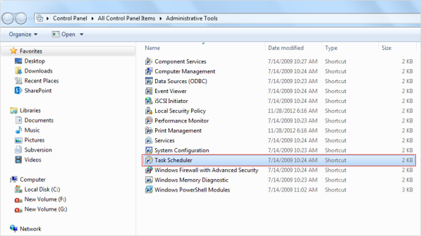

  3. Open Task Scheduler from Start > Control Panel > Administrative Tools > Task Scheduler.

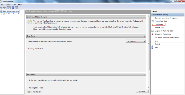

  4. Click the Create Task option under the Actions column to create a new task.

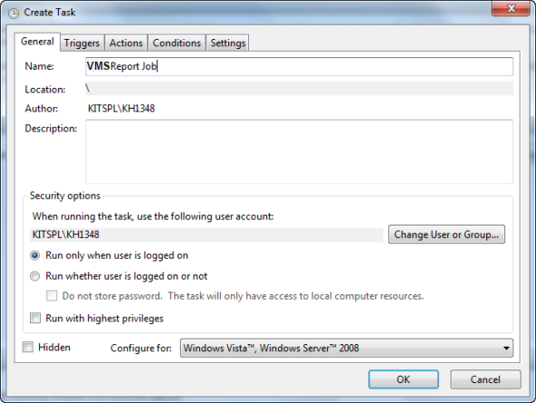

    The Create Task window appears. The Create Task window includes five tabs: General, Triggers, Actions, Conditions and Settings. By default, the General tab is set to active.
  5. General: Under the General tab, enter the task name as VMS Report Job.

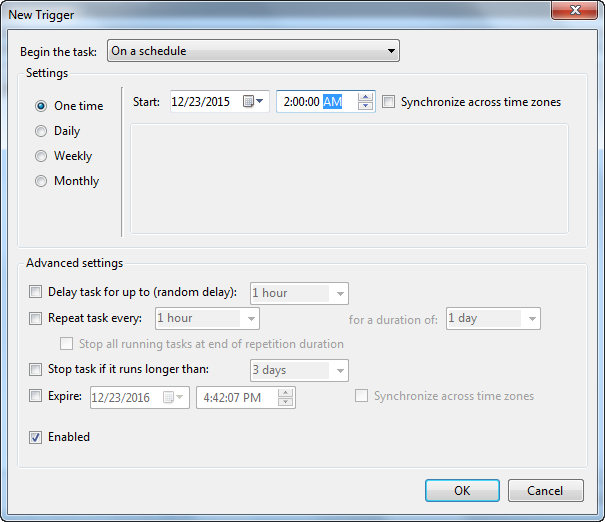

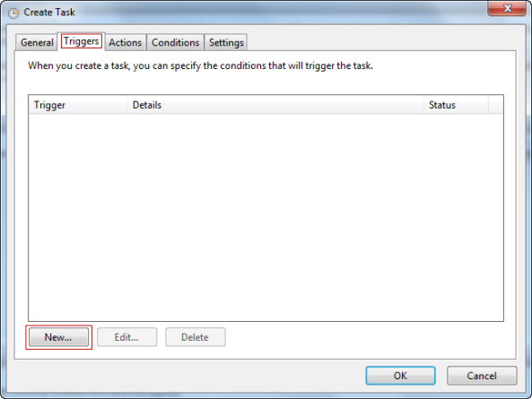

  6. Triggers: Under the Triggers tab, click New.
    1. Create a schedule that runs at 02:00 a.m. on daily basis.
    2. Click Ok to continue.

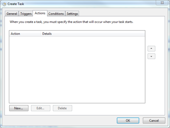

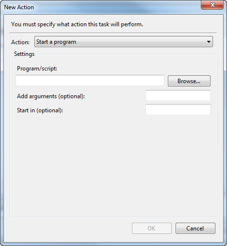

  7. Actions: Under the Actions tab, click New.
    The New Action window appears.
  8. Program/Script: Click Browse to select vpns_job.bat. file from your system.
  9. Click Ok to create a new task.
