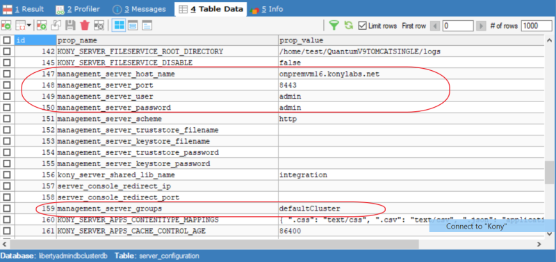

- Update the Integration cluster name, Management server host name, user, and password in the
server_configurationtable of adminDB for the Liberty profile.
For more information, refer to the following screenshot.
