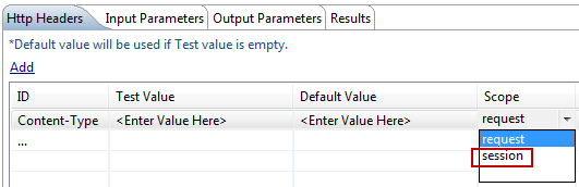

  • How can I add Headers?
Solution
For example, to add "Content-Type" as a header:
In the Service Definition editor -> Http Headers tab, under Id, declare Content-Type as header type and under Session, select session from the drop-down list as shown:
Write preprocessor for the service and use the following snippet in preprocessor:
    Session session = request.getSession();
    session.setAttribute("Content-Type"," application/json");

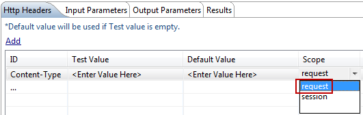

If you want to pass header values in "request" parameters,
In the Service Definition editor -> Http Headers tab, under Scope, select request from the drop-down list, then pass the header value with same key that you defined in Header section with request as scope.
For example,
1)
    Content-Type - request scope in Volt MX Iris Header section
    2)Use the below code in JavaScript
    var inputParamTable={};
    inputParamTable["Content-Type"] = "application/json";
