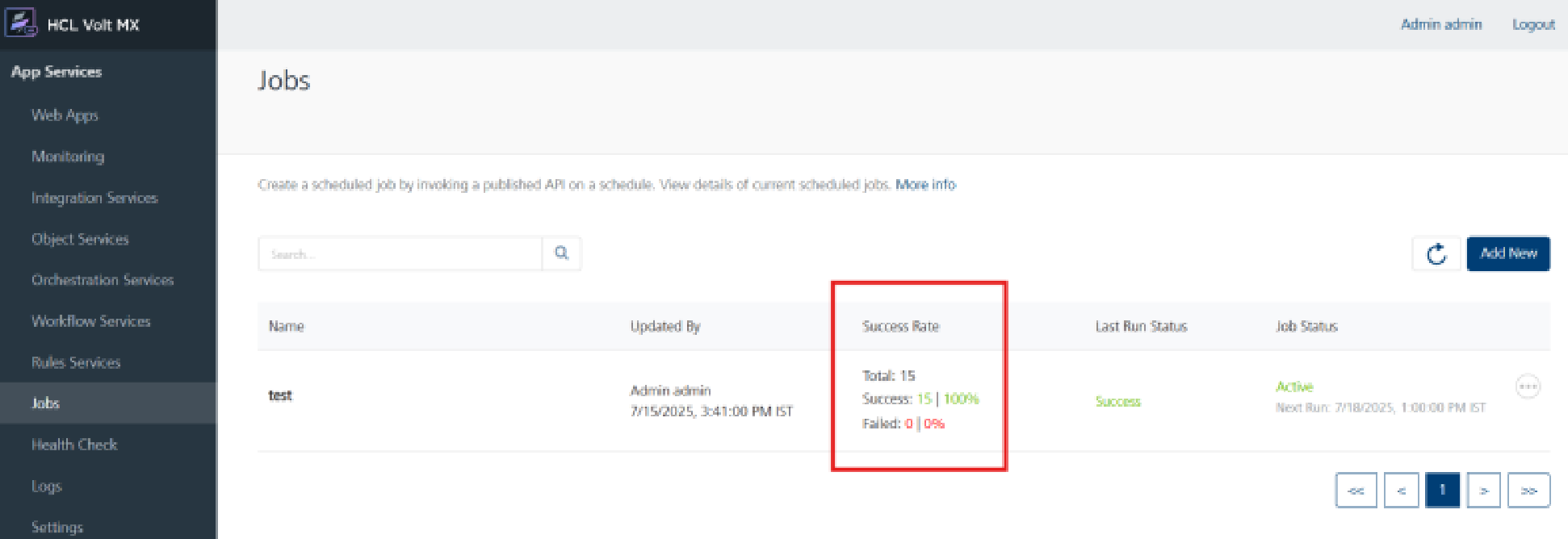

View Job History
This page will show the history of job as shown in below screenshot.
User can clear history of using button “Clear History”.
Clear History will delete history of that job, Clearing the job history using "Clear History" will not reset or delete the Success Rate (job statistics) shown in below screenshot of that particular job.

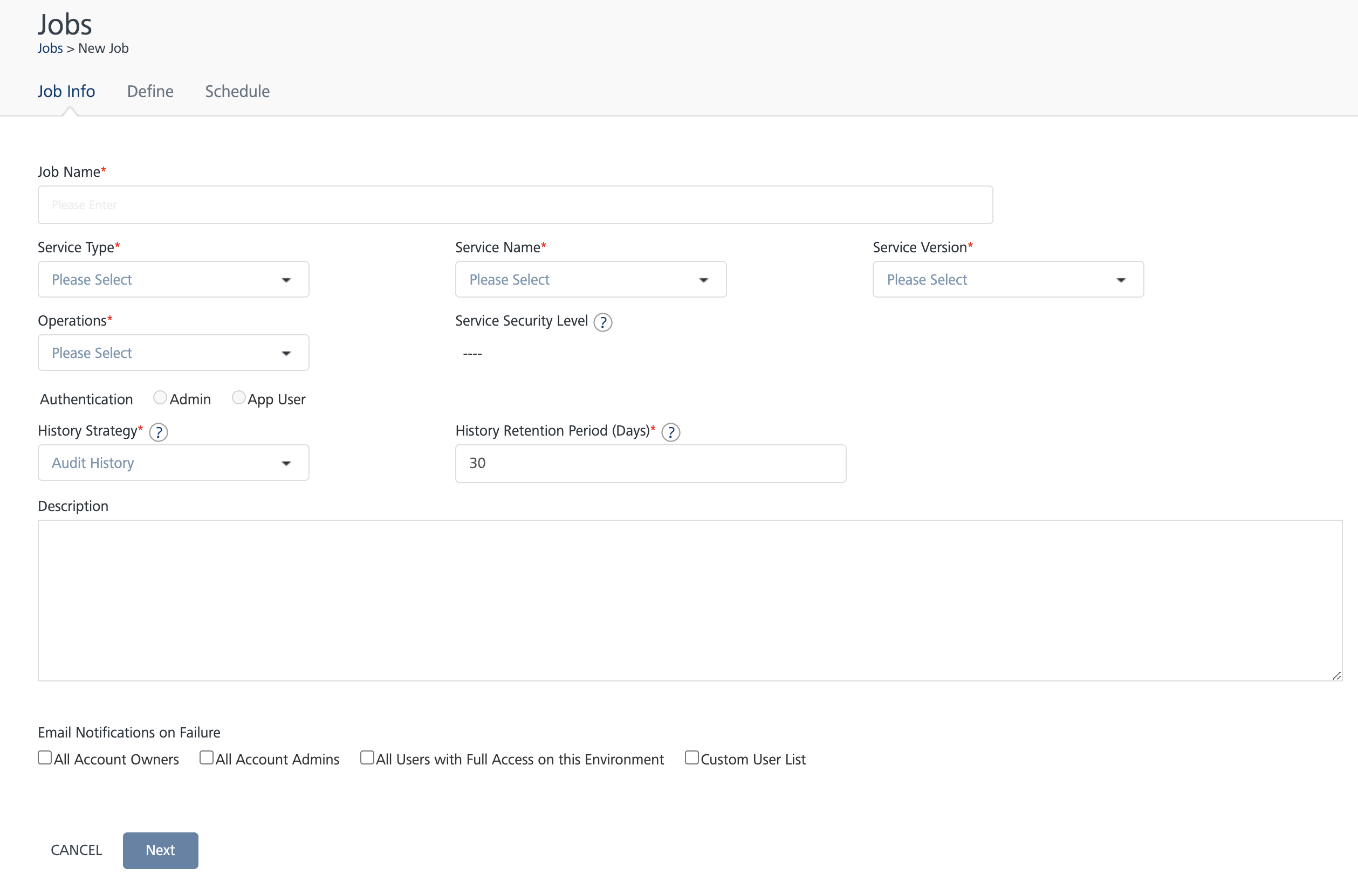

To create a new job, click Add New from the upper right corner of the Jobs screen. The New Job windows displays the following three tabs:
Job Info
The Job Info window displays the fields required to create a new job. Enter the required details in the fields provided:
| Field Name | Description |
| Name | Enter the name of the job. |
| Service Type | Select the service type from the list: Integration Orchestration Object Services |
| Service Name | Select the service name from the displayed list. The service name displays the list of available services for the selected service type. Note: Based on the service type selected, the service name field displays the services created and published in Volt MX Foundry Console. |
| Service Version | Select the version number of the service. By default, the service version list displays the version number 1.0. The service version is predefined during the process of creating a service in Volt MX Foundry Console. |
| Objects | Select the objects for the selected service. The Objects list displays the predefined objects for the selected service. The objects field displays the services in Volt MX Foundry Console during the process of creating a service. Note: The Objects field is displayed only when the user selects the service type as Object Services. |
| Operations | Select the operation from the list. The operations are predefined while creating the service in Volt MX Foundry Console. Important: Public, Anonymous App User and Authenticated App User operations are available under Operations list while creating the Jobs. |
| Service Security Level | Based on the selected operation, the security level (Public, Anonymous App User or Authenticated App User) is displayed. |
| Authentication | For Anonymous App User and Authenticated App User operations, you have two options. You can select any option and provide your login credentials for authenticating the selected operation. Admin: If you are an admin, select the option and perform the following actions: Enter your login credentials Click Test to validate the login details. Note: Admin credentials are used only for the services which does not require the backend authentication. App User: App Users are considered as two types: Authenticated App User and Anonymous App User. Authenticated App User: On selecting a private operation, you are considered as an Authenticated App User. Anonymous App User: On selecting a protected operation, you are considered as an Anonymous App User. If you are an Authenticated App User (for Private operation), click the App User option and perform the following actions: App: Select the app to which the service is associated. Identity: Select the identity associated with the selected service. Username and Password: Provide the login credentials. Test: Click Test to validate the provided details. If you are an Anonymous App User (for Protected operation), click the App User option and select the app to which the service is associated. Note: Login credentials are not required for an Anonymous App User. |
| History Strategy | Displays the following options to view the job history. No History: History will not be tracked. Audit History: The history related to the audits is saved and displayed.> Note: The history of request and response of the job run is not logged. Full History for Failed Runs: The complete history of failed runs is displayed. Full History for All Runs: The complete history of all the runs is displayed. |
| History Retention Period | Enter the period of history maintenance in the server. By default, the field displays 30 days as the retention period. Note: The server removes the history after the retention period expires. |
| Description | Enter the description of the new job created. |
| Email notifications on Failure | Email notifications are automatically sent by the server on the failure of the created jobs. The email notifications contains the job failure information. You can select any of the following options for the email notifications to be sent: All Account Owners: Email notifications are sent to all the owners of the logged in account. All Account Admins: Email notifications are sent to all the administrators of the logged in account. All Users with Full Access on this Environment: Email notifications are sent to all the users having full access to the environment associated to the logged in account. Custom Users List: You can customize the list of users by entering their email address to receive the email notifications. Note: Custom users must have access to the environment to receive the email alerts. |
| Cancel | Abort the operation or cancel creating a new job. |
| Next | Proceed to the next screen. |

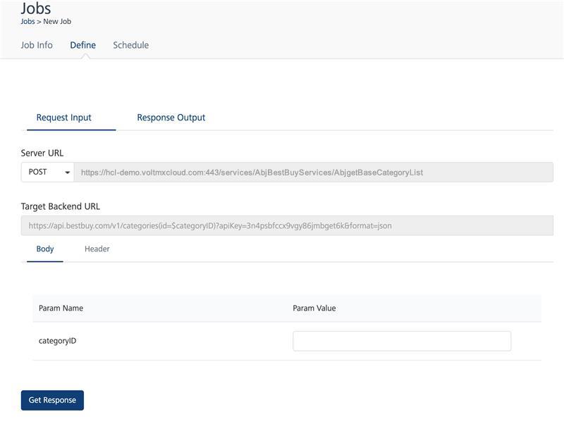

In the process of creating a new job, you need to define the request input parameters. To access the Define window, perform the following actions:
Click Add New from the upper right corner of the Jobs screen.
The New Job window displays the following three tabs:
- Job Info
- Define
- Schedule
- Enter the required information in the fields displayed in the Job Info window and click Next.
The Define window appears.
The Request Input window displays the following fields:
| Field | Description |
| Operation | The selected operation in the Add New window is displayed. |
| URL | The server URL for the selected service and operation is displayed. |
| Query Params | Enter the query parameter for the selected operation. |
| Field Name | All the field names provided while creating the service are displayed. |
| Field Value | Enter the field values across the field names. |
| Get Response | Select to parse the input values and get the response. |
To get the response parameters for the new job added, follow these steps:
In the Add New Job window, fill all the mandatory fields and click Next.
Enter the query parameters against the selected operation.
- Provide the field values against the field names displayed.
Click Get Response.
The Response Output tab displays the response for the request parameters provided. The Response Header and Response Body sections display the response for the input parameters provided.
Note: When user sets the string, it acts as a criteria for a job success or failure. If the specified string is present in the response output the job is considered as success, else the job is considered as a failure. After entering the success criteria, you can click Test to check the number of matches for the string in response.
Note: Success criteria can be set only for the responses whose opstatus is 0.
Click Next.
The Schedule window appears.
Note: The job might fail with an error Internal error during job execution, if the service does not return proper JSON response or if the service is modified/deleted after creating the job.
