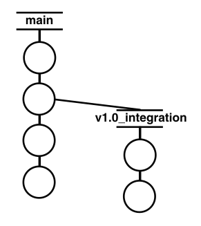

For example, before the Boston site starts using MultiSite,
the element
cmdsyn.c has two branches, cmdsyn.c@@/main and cmdsyn.c@@/main/v1.0_integration:

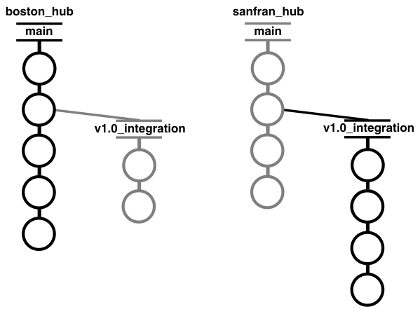

When the Boston site starts using MultiSite, the administrator creates a new replica for the San Francisco site. Because integration for Version 1.0 will be done at the San Francisco site, the sanfran_hub replica must master the v1.0_integration branch type. The administrator transfers mastership of the v1.0_integration branch type to the sanfran_hub replica.
Developers in San Francisco can now create versions on existing branches
of type v1.0_integration and can create new instances of that branch
type. Work continues on the main branch in Boston:

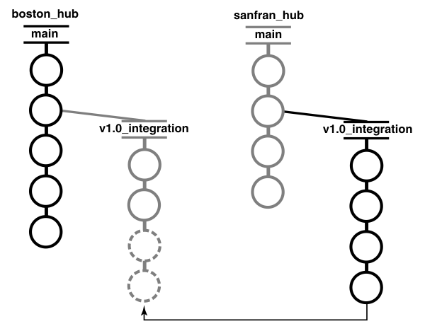

The administrators at the Boston and San Francisco sites decide to merge
some of the work on the v1.0_integration branch with the work done
on the main branch. The San Francisco administrator sends an update
packet to the boston_hub replica, and the Boston administrator imports
it:

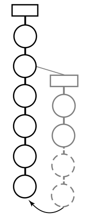

The Boston administrator then merges from the v1.0_integration branch
to the main branch by checking out the latest version on the main branch,
merging from the latest version on the v1.0_integration branch, and
checking in the result of the merge:
