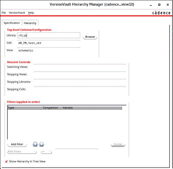

The following image shows the Hierarchy Manager in a typical scenario:
Figure 2: The Hierarchy Manager
A typical use-case scenario for the Hierarchy Manager. The fields specify the cellviews to list.
In this scenario, a top-level cellview specified with various controls for the hierarchy elaboration and cellview list filtering. SKILL pattern matching meta-characters are used in many fields.

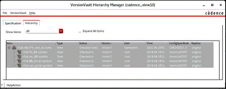

Figure 3: The list of cellviews in the Hierarchy Manager
A list of cellviews that result from the specifications in the previous image.
Although the entire cellview list is automatically selected, you can select any subset of the items to operate upon before starting a VersionVault design management operation. Use the typical Windows actions to make selections, such as Ctrl+A to select all items.
The Hierarchy Manager includes the following controls:
Specification tab
The Specification tab contains the controls for producing the set of cellviews to be considered for design management operations. The tab contains these fields:
Top-level Cellview/Configuration group
This group of fields determines a cellview that specifies a Virtuoso configuration or the top-level cellview from which the hierarchy descent is to take place. The group contains these fields:
Library
This field accepts a single string with no embedded whitespace characters. No pattern matching is performed on the value. All characters in the name are taken literally. This name must match one of the libraries that is referenced in your design environment.
Cell
This field accepts a single string with no embedded whitespace characters. No pattern matching is performed on the value. All characters in the name are taken literally. This name must match one of the cells in the library that is identified in the Library field.
View
This field accepts a single string with no embedded whitespace characters. No pattern matching is performed on the value. All characters in the name are taken literally. This name must match one of the views in the cell that is identified in the Cell field.
This group also includes a Browse button, which is similar to many other Virtuoso forms. When you click Browse, the standard Library Browser interface opens as shown in The Library Manager. Selections in this browser directly affect the Library name, Cell name, and View name fields of the Hierarchy Manager. Using this browser is more convenient and more accurate than typing names.
If any fields in the Top-level Cellview/Configuration are improperly specified, the Hierarchy tab is inaccessible and the items in the VersionVault menu are unavailable. After an acceptable set of values is provided, the Hierarchy tab and the VersionVault menu items are accessible again.
Descent Controls group
With this group of fields, you specify the manner in which the hierarchy descent takes place, starting at the top-level cellview. Most controls limit the depth that the hierarchy descent achieves. However, the Switching views control, which is discussed later, determines which view that belongs to a given instance's master cell is used for hierarchical descent.
All fields in this group recognize SKILL pattern matching meta-characters. For more information regarding SKILL pattern matching, see the "Pattern Matching of Regular Expressions" section in the "Cadence SKILL Language User Guide" of the Virtuoso documentation. These controls and the pattern matching mechanisms that are built into them offer a great deal of flexibility. The Descent Controls group includes these fields:

Hierarchy tab
This tab contains the set of cellviews that results from the settings on the Specification tab. When you click the Hierarchy tab, the Hierarchy Manager attempts to open the configuration or top-level cellview that is specified in the Top-level Cellview/Configuration fields. If the process succeeds, the Hierarchy Manager determines the type of data in the cellview. If it is a Virtuoso configuration, the contents of the configuration specifies the initial cellview list. If it is a Virtuoso design data cellview (such as a schematic or a layout), the Hierarchy Manager applies the descent controls as it elaborates the hierarchy to produce the initial cellview list. If any are present, the Hierarchy Manager applies filter criteria in the order that they appear in the Specification tab. The resulting cellview list is then populated on the Hierarchy tab.
Tips:
  • Large design hierarchies might result in a delay when you initially switch to the Hierarchy tab. You might experience this delay again if changes are made to the contents of the Specification tab.
  • If the information on the Specification tab is incomplete, refers to a non-existent cellview, refers to a cellview that is other than a Virtuoso configuration or Virtuoso design data, or refers to a cellview that contains no hierarchy, the Hierarchy tab shows an empty list.
  • Some combinations of filter criteria can eliminate all cellviews that are found in the hierarchy. In this case, the Hierarchy tab shows an empty list.
Cellviews list contents
The cellviews are reported in columnar format, one cellview per row, as shown in The list of cellviews in the Hierarchy Manager.
The columns contain the following information:
  • Item: The library name, cell name, and view name of each cellview, separated by spaces.
  • Type: The type of data. Currently, only the view type information is listed here.
  • Status: The data management status of each cellview. The information in this column is initially reported with ellipses (…) but is asynchronously updated for managed data. For unmanaged data, this column's cells retain the ellipses.
  • Version: The data management version of each cellview. The information in this column is initially empty but is asynchronously updated for managed data. For unmanaged data, this column's cells remain empty.
  • User: The user ID of each cellview owner.
  • Time: The modification date and time of each cellview owner. The information in this column is initially empty but is asynchronously updated for managed data. For unmanaged data, this column remains empty.
  • ConfigSpecRule: The config spec rule that is used to derive each cellview. The information in this column is initially empty but is asynchronously updated for managed data. For unmanaged data, this column remains empty.
  • Replica: The replica information for each cellview appears in this column. The information in this column is initially empty but is asynchronously updated for managed data. For unmanaged data, this column remains empty.
