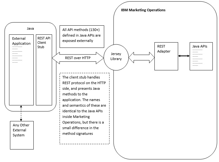

REST API workflow
Process details
The base path for REST API client stub is <MO Home>\devkits-rest\integration.
The client stub and other required libraries are located at <MO Home>\devkits-rest\integration\lib.
Example code for usage of the client stub is located at <MO Home>\devkits-rest\integration\examples.
The directory bin under this directory has a sample batch file that can build the example code. This example code has usage details of various API methods than you can program.
Javadocs for the JAVA methods supported for the REST API are located at <MO Home>\devkits-rest\integration\javadocs.

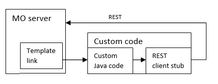

Usage scenario with template links:
Template links usage scenario

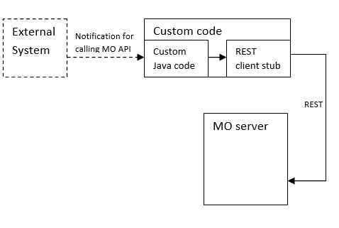

Standalone or external trigger usage scenario
