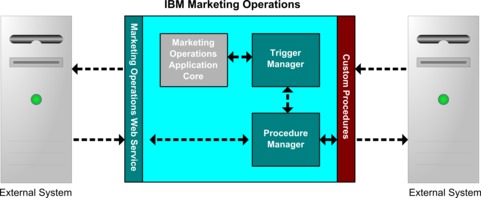

The API interface interacts with Unica Plan at the programmatic level, in the same way the GUI interfaces with Unica Plan at a user level. Using the API, you construct procedures. Using these procedures, you communicate between Unica Plan and external systems. The Unica Plan Webservice is the container object for the procedures, API, and triggers.
The architecture of the Unica Plan Integration Services is shown here.
Integration Services communicating with each other, and with external systems
The following are key components of the Integration Services.
  • Unica Plan Procedure Manager: extends the business logic by interacting with Unica Plan through the API.
  • Unica Plan Trigger Manager: associates a condition (for example, the state change of a marketing object) with an action (a procedure to run when the condition for the trigger is met).

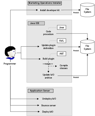

You use the components of Unica Plan Integration Services to develop custom procedures, as shown in the following diagram.
Programmer uses the Unica Plan Installer, Java IDE, and Application Server
After you install the developer's kit, you follow these basic steps:
  1. Code the custom procedure.
  2. Update the plug-in definition in the XML definition file.
  3. Build the plug-in:
    1. Compile the necessary classes.
    2. If you are using a third-party library that is not in the Unica Plan archive, bundle the library inside the plan.war file and redeploy.
  4. Restart Unica Plan. Changes to the procedure classes are applied when you restart the application server.
    If you change the plan.war file, you must undeploy and redeploy Unica Plan with the new plan.war file. Undeploy and redeploy Unica Plan if you use a third-party library that is not in the Unica Plan archive and you edit the plan.war file.
