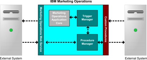

The architecture of the Marketing Operations Integration Services is shown here.
The following are key components of the Integration Services.
- Marketing Operations Procedure Manager: extends the business logic by interacting with Marketing Operations through the API.
- Marketing Operations Trigger Manager: associates a condition (for example, the state change of a marketing object) with an action (a procedure to run when the condition for the trigger is met).

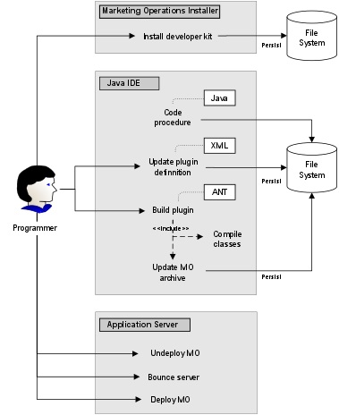

You use the components of HCL Marketing Operations Integration Services to develop custom procedures, as shown in the following diagram.
After you install the developer's kit, you follow these basic steps:
- Code the custom procedure.
- Update the plug-in definition in the XML definition file.
- Build the plug-in:
- Compile the necessary classes.
- If you are using a third-party library that is not in the Marketing Operations archive, bundle the library inside the plan.war file and redeploy.
- Restart Marketing Operations.
Changes to the procedure classes are applied when you restart the
application server.Note: If you change the plan.war file, you must undeploy and redeploy Marketing Operations with the new plan.war file. Undeploy and redeploy Marketing Operations if you use a third-party library that is not in the Marketing Operations archive and you edit the plan.war file.
