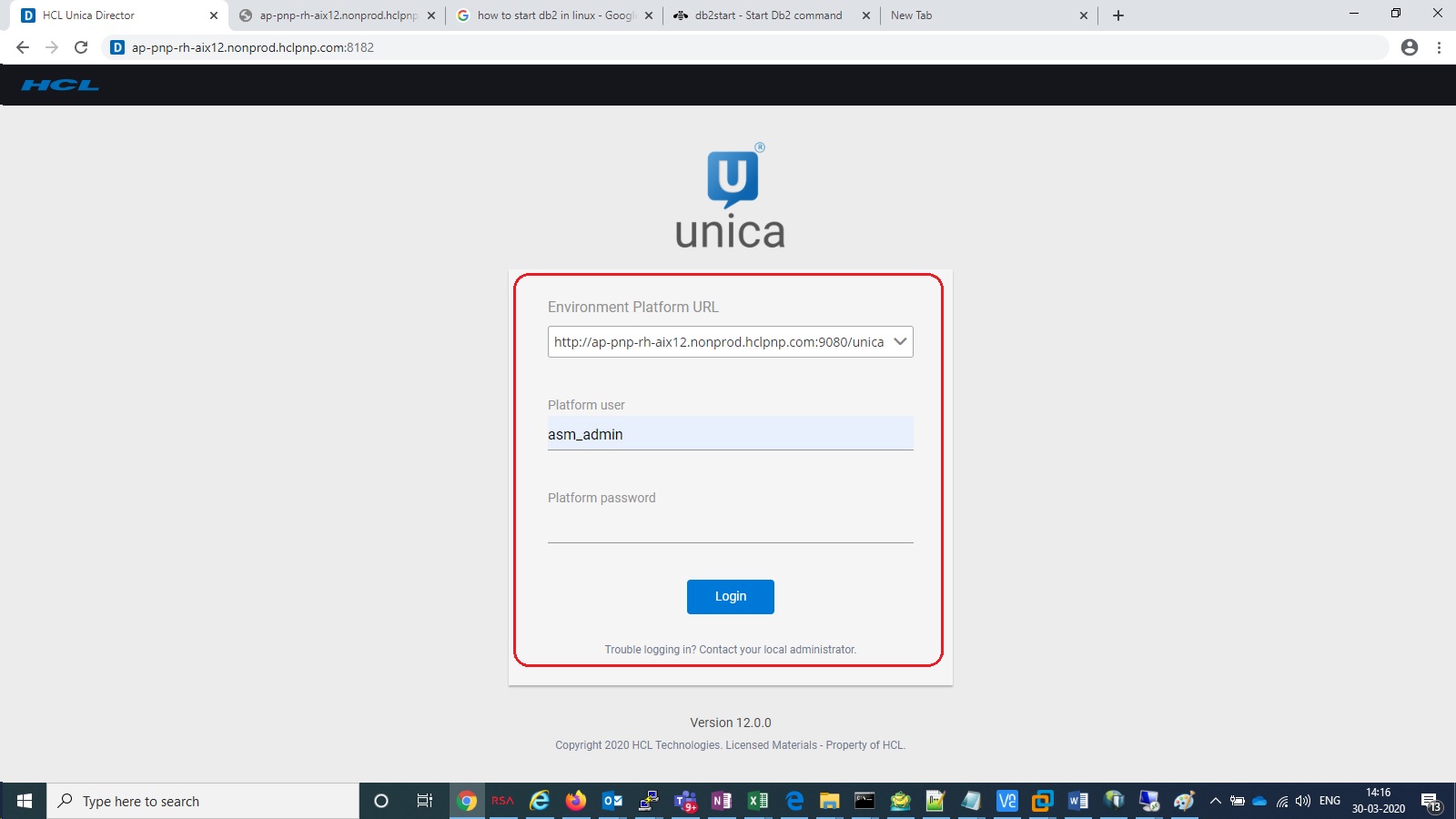

  1. On the login page of the Unica Director, you should specify the environment - the Unica Platform URL (for example http://<url>:<port>/unica) , also in case when Web access control login method is configured, that is, Siteminder or ISAM, then too the Unica Platform URL (for example http://<url>:<port>/ unica) should be specified.
  2. Then enter your Unica Platform login credentials.

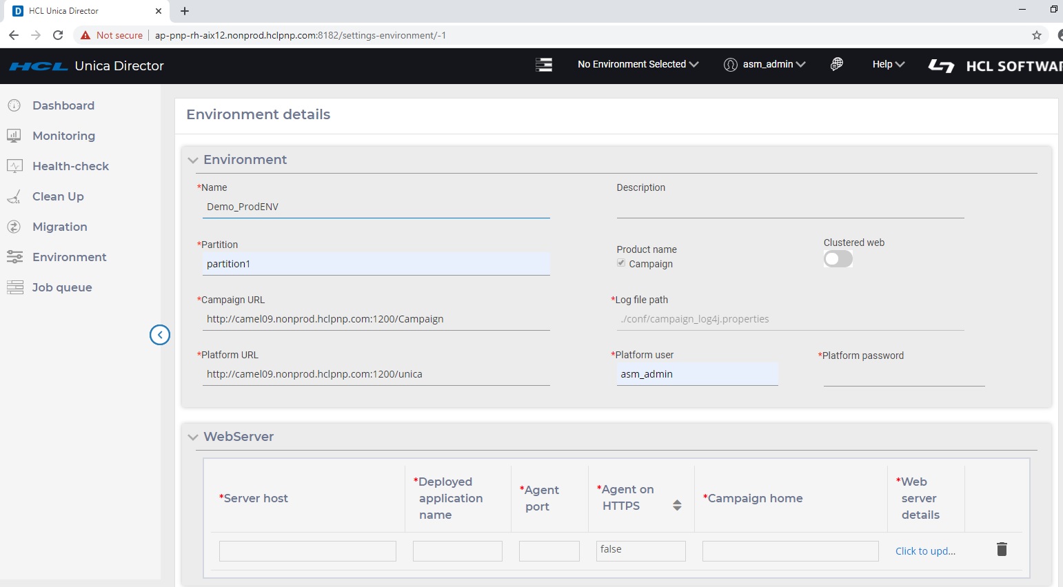

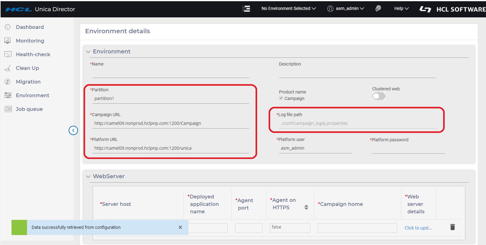

  3. Log on to the Unica Director and navigate to the Add Environments screen. The following fields are auto populated for ease of adding environment details:
    • Partition
    • Unica Campaign URL
    • Unica Platform URL
    • Log configuration path
    • DataSources information
    • Listener information
  4. You are must enter the necessary details in the Application Servers and Listener section before saving the details. Each fields detail is given in Add Environment section
  5. Once the environment is added it is automatically selected as the working environment. You can see the selected environment in the right hand top corner. The various required Unica Director actions will be performed on this selected environment

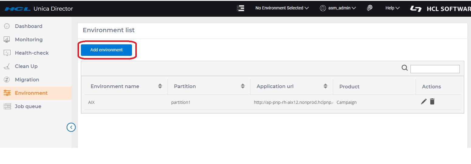

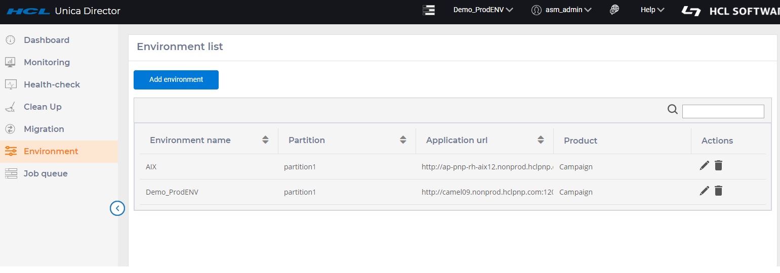

  1. Log on to the Unica Director and navigate to the Environments screen.
  2. After you log in and select the Environment option on the left menu bar you will see the environment list screen.
Click on Add environment
Click on Add environment.

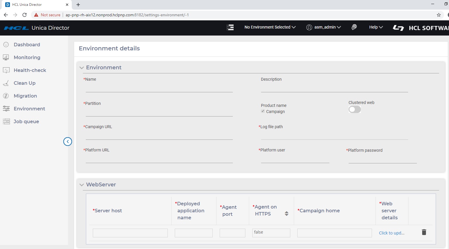

Enter Details
  1. Enter the name and description of your choosing for the environment
  2. Enter a partition name
  3. Enter the Platform URL
  4. Enter your platform credentials (user id and password)
  5. Clustered Web: This option specifies if this environment is a web cluster or standalone. If this option is not enabled, then you can enter only one record in the WebServer. If this option is enabled, you can add details of all the nodes in the cluster
    Note: If you have already added details of all the nodes in the cluster with this option enabled and then if you disable this option, all application server entries are removed

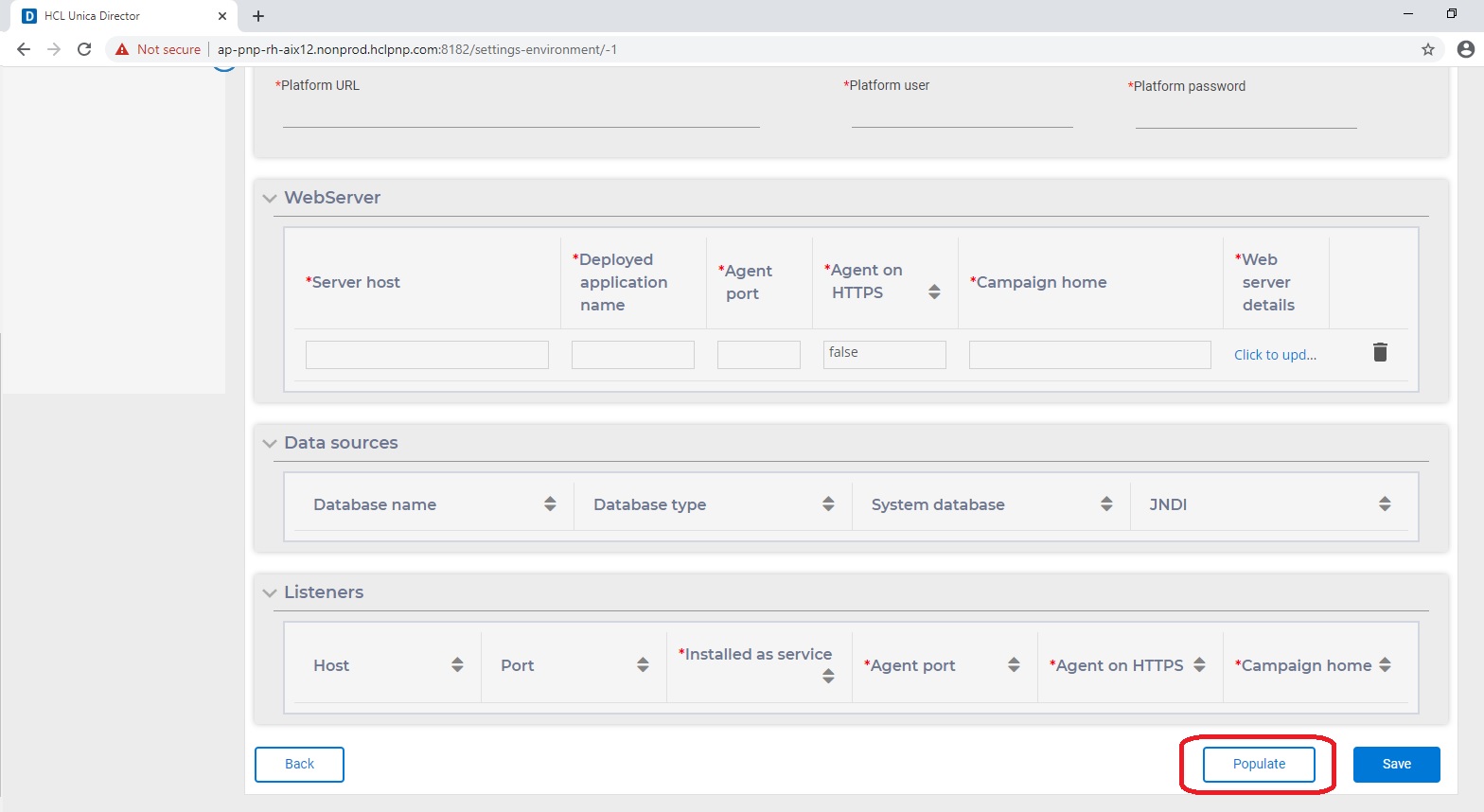

  6. Scroll down to the bottom of the screen
    Click Populate
  7. Click on ���Populate��� This will result in most of the fields getting populated automatically. However, the Webserver and Agent details must be filled out manually
    Click Populate
    Click Populate

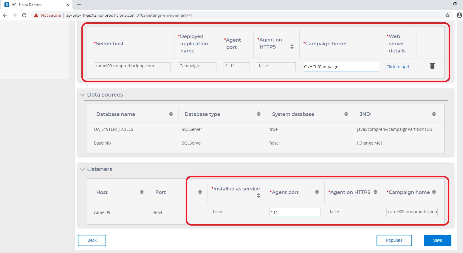

    Application Servers - Web Servers:
    User must enter below details to save the Application Server details:
    1. Server Host: Enter the fully qualified host name where the application server is running.
    2. Deployed Application Name: Enter the Unica Campaign application name ���
      • for Weblogic by default it is Campaign,
      • for Websphere, Tomcat and JBOSS you can specify the application name given while deploying Campaign.war file. This name is used to start and stop the application from the Health Check screen.
    3. Agent port: Specify the Unica Director Agent port.
    4. Agent on HTTPS: Set this to True or False as applicable.
    5. Campaign home: Specify the Campaign home.

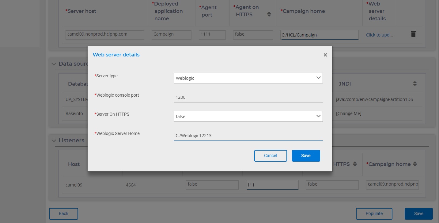

    6. Web Server Details: Click Update. Select the type of server, that is, Weblogic, Websphere, Tomcat or JBoss:
      ServerType - If the Server Type selected is "WebSphere"
      • WebSphere Profile Path -> Specify the Application server profile location. e.g. /opt/IBM/WebSphere/AppServer/profiles/AppSrv01
      • WebSphere Server Name -> Specify the Application server name where Unica Campaign application is deployed. For example - WebSphere by default has server name as "server1"
      • WebSphere Node Name -> Specify the WebSphere application server node name where the Unica Campaign application is deployed
        E.g. -zebra658Node01 - You can get these details from the websphere admin console.
      ServerType - If the Server Type selected is "Weblogic"
      • Weblogic Console Port -> Port number used by Weblogic Console
      • Server on https -> Is Weblogic Server on https
      • Weblogic Server Home -> Path of Weblogic Home e.g. C:\webservers\WL12213
      ServerType - If the Server Type selected is "Tomcat"
      • Tomcat JMX Port -> JMX port for Tomcat
      ServerType - If the Server Type selected is "JBoss"
      • JBoss Admin Port - Management http port/console port which you can get from standalone.xml file
      • JBoss Server Home - JBoss Application Server installation directory.
      Web Server Details
  8. After entering all the required Webserver information and other required fields please click on ���Save���. Your configuration data will be saved and available for use in (Unica Director).
    Save_Data
  9. Add the Listener Details
    Listeners: Listener host and ports fields are auto populated. You must enter information in the fields.
    Listener Installed as Service: You should select true / false per whether the listener has been installed as a service.
    • Agent Port: Specify the Unica Director Agent port.
    • Campaign home: Specify the Campaign home.
    • Agent on HTTPS. You should select True/False
  10. Save the environment
    Note: For each partition, you will have to create a new environment.

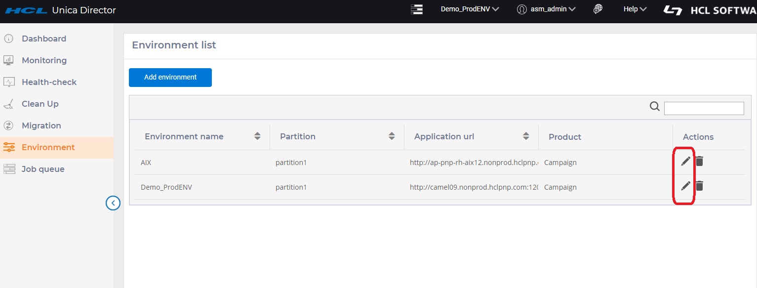

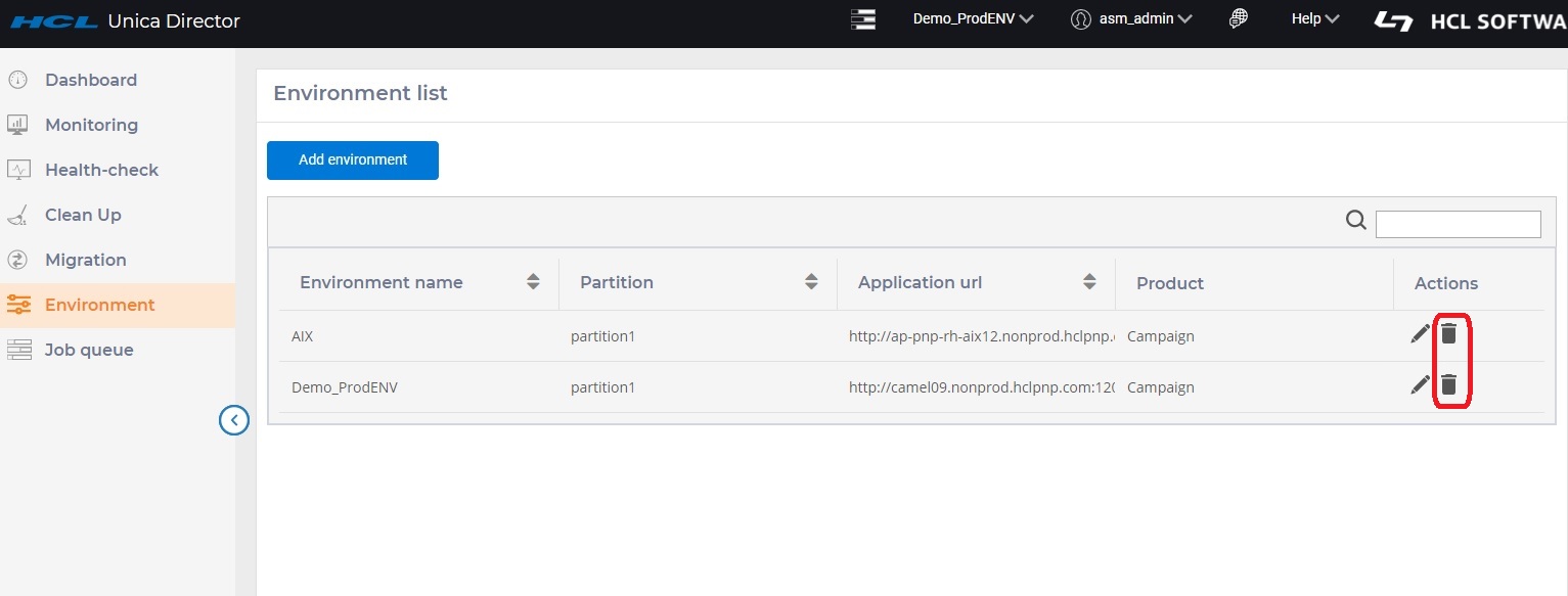

You can modify an existing environment by clicking on the ���edit��� icon (the pencil shape) under the Actions column of the environment you want to edit.
This will open the environment details page (as shown in the ���Add Environments��� section). After making your changes click on the ���Save��� button to ensure that your modifications have been saved. Note: If a Listener is added, deleted or updated, this change will not be reflected in the Unica Director. For Unica Director to reflect the changes, the pertaining environment must first be deleted from Unica Director and then re-added so that the latest Listener will be available to the Unica Director Delete Environments
Modify Environments
You can delete an environment even if it is in use. Click on the ���Delete��� icon (trash can��� under the Actions column of the environments list
You should be very careful while deleting an environment as it might have a significant impact other users using the environment.
