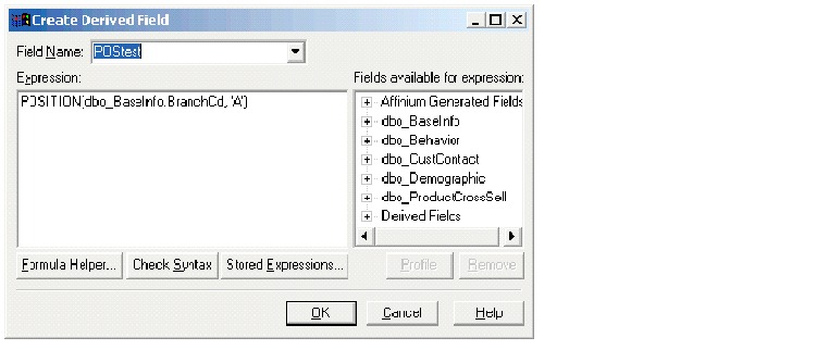

In the example below, we are searching for the pattern or string, 'A ', within the value of the column, dbo_BaseInfo.BranchCd, and assigning the returned value to a derived filed POStest.

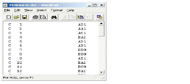

The following example shows a few rows from the table with the values from dbo_BaseInfo.BranchCd and POStest shown side-by-side.
