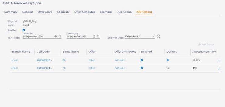

By default, A/B testing is disabled for a rule. To enable it, click , the A/B icon to the right of a rule. The Advanced Options slider displays. Perform the following steps.
  1. Select the Enabled checkbox. This adds base rule as first branch in Branch table.
  2. Under TestPeriod, provide the Effective and Expiration dates.
  3. Inthe Selectionmode list, select one of the following options.
    • Use Default: Select this option if you want the offer to be served from the default branch out of A/B test branches, regardless of the higher acceptance rate of any offer.
    • Use base: Select this option if you want the offer to be served from the treatment rule, regardless of the higher acceptance rate of any offer.
    • Auto Selection: Select this option if you want the offer to be served from one of the A/B test branches having highest acceptance rate. Acceptance rate is calculated as ratio of response count to contact count.
      Once "Auto Selection" or "Use Base" option is selected, then Default Branch column willbe hidden. If there is performance data in Acceptance Rate column, then branch information can be read only.
  4. ClickAdd Branch to add more branches in Branch table.
  5. Click Apply changes.

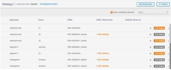

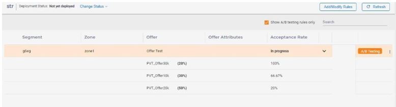

In the Strategy Rule list page, select the ShowA/B testing rules only checkbox to display the rules with A/B testing and acceptance rate column with ABT status and acceptance rate of each branch.
There can be four statuses for Acceptance Rate column for base rule including disabled, yet to start, in progress, and finished. In case, you select the "Use Default" or "Auto Selection" selection mode, a "check-mark" near the selected branch is displayed.
For any rule that has A/B testing data defined, there is "A/B Testing" icon located on the right. The orange color means it is active and grey color means it is disabled.

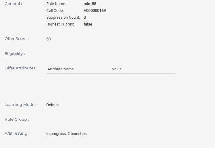

ABT Summary page displays the ���ABT status��� and ���number of branches��� for the A/B test.
