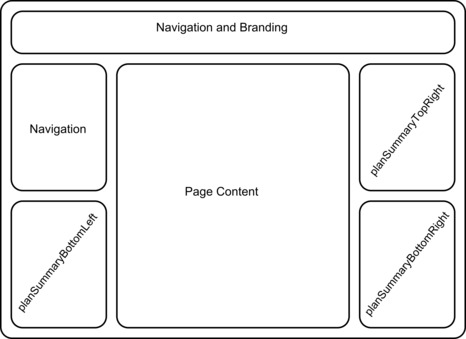

Identify requirements for the cell phone plan summary page
The following diagram shows the layout for the cell phone plan summary page.
| Requirement | Implementation |
One offer to be displayed in a zone that is dedicated to offers about upgrades The area on the page that displays the upgrade offer must be defined. Also, after Unica Interact picks an offer to display, the information must be logged. |
Two offers for phone upgrades Each area on the page that displays the phone upgrades must be defined. |
For analysis, you need to log which offers are accepted, and which offers are rejected. |
You also know that you must pass the treatment code of an offer whenever you log an offer contact, acceptance, or rejection. |
Display three rotating images on the page. Link the images to the offers. |
