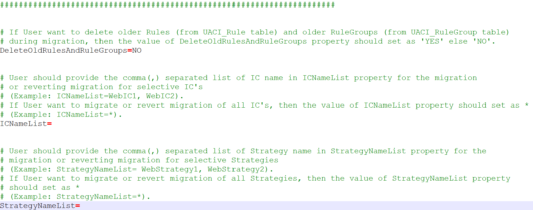

Properties setups for the strategy migration utility
Before running this utility, users must navigate to the path <Installation_Directory>\Interact\interactDT\tools\upgrade\conf and open ���StrategyMigration.properties file for configuring properties required for the desired migration or reversion.
Users must change the following properties based on the usage.
  • DeleteOldRulesAndRuleGroups: This property decides whether the migrated rule group (UACI_RuleGroup) and rule (UACI_Rule) data after migration must be deleted. This property is only applicable for migration.
    • If this property is set to YES, then the migrated strategy cannot be reverted to the old model. Therefore, it is recommended to keep the value of this property to NO, so that there is a possibility of comparison to decide whether reversion is required after migration. In case this property is set to YES, you must keep the back up of data for UACI_RuleGroup and UACI_Rule tables.
    • If this property is set to No, the old strategy is still available for viewing through the associated campaign object. However, it cannot be edited or deployed.
  • ICNameList: This property specifies the interactive channels whose strategies will be migrated or reverted. It must be a comma (,) separated list of interactive channel names. For example: ICNameList=WebIC1, WebIC2. If the strategies in all interactive channels are required to be migrated or reverted, use an asterisk (*) as the value: ICNameList=*.
  • StrategyNameList: This property specifies the strategies that are migrated or reverted. It must be a comma (,) separated list of strategy names. For example: StrategyNameList= WebStrategy1, WebStrategy2). If all strategies need to be migrated/reverted, use an asterisk (*) as the value: StrategyNameList=*.
    Note: ICNameList and StrategyNameList work together to determine which strategies will be affected. In other words, a strategy specified in StrategyNameList must exist in an interactive channel specified in ICNameList in order for it to be migrated or reverted.
