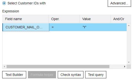

The Expression box shows columns labeled Field name, Oper, Value, and And/Or.

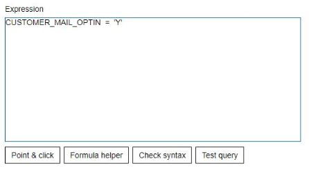

When the button says Text Builder, you can build expressions by populating the columns labeled Field name, Oper, Value, And/Or.
When the button says Point & click, you can view or edit raw SQL and you can use the Formula helper to pick macros, operators, and string functions from a list.
With either method (Text Builder or Point & click), you can select fields from the Available fields list, including Campaign Generated Fields and Derived fields.

To specify which field to query, click in the Field name cell. The
Available fields list should appear. If the list does not appear, click in
the Field name cell again. In the Available fields
list, expand the fields until you see the one that you want. Select an available field by
double-clicking it or by highlighting it and clicking Use.

- Click in the Oper cell, then double-click a comparison operator in the Operators list (=, <, >, <=, >=, <>, In, Not in, Between).
Click in the Value cell, then double-click a value. If no values appear,
double-click (Profile...) in the Values list to open the Profile
selected field dialog so you can select from a list of values. You can also double-click
in the Value cell to edit the value directly.

Optionally, click the Text Builder
button so its label changes to Point &
click. When the button says
view or edit raw SQL. You can also use the
macros, operators, and string functions from a list. Note: If your query includes a table field that has the same name as a Campaign generated field, you must qualify the field name. Use the following syntax:
<table_name>.<field_name>.For related information, see Creating raw SQL queries. Also see Creating queries with Formula helper.
- Click the Point & click button to change back to the original query mode. The button label changes back to Text Builder.
