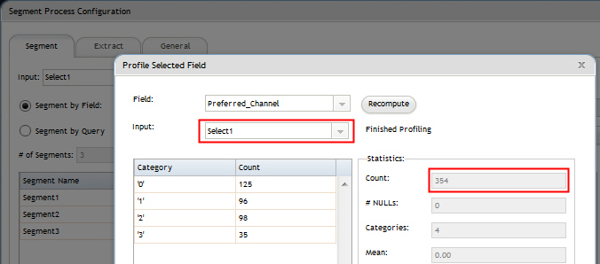

- The selection that you make in the Input list of the Profile Selected Field dialog determines how many records are profiled. If you choose None, Campaign profiles all of the records. If you choose the incoming Select box as the Input, Campaign profiles only the records that were selected by that process. If the Select process query resulted in only 354 records, Campaign profiles only those records.
The following example shows a restricted profile, where the Input is set to Select1.
