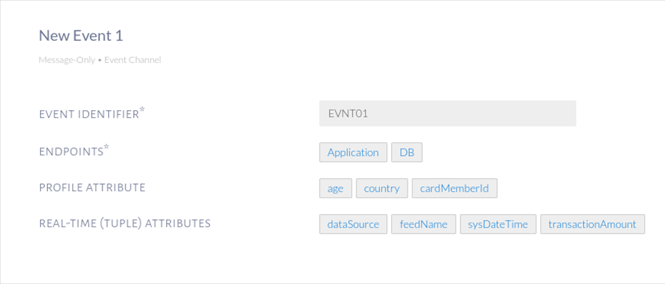

A sample screenshot shown below within an event configured in Detect where we select the attributes and populate an event identifier to push to downstream kafka topic for Unica Interact to ingest.

        "event": "EVNT01" # Value from 'Event Identifier' configured on UI
