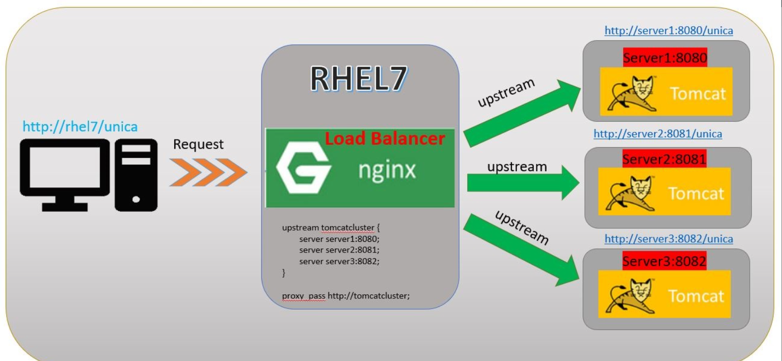

Architecture
Steps to Follow
  1. Tomcat Installation - server1
    Download and install Tomcat server and listen on 8080
  2. Tomcat Installation - server2
    Download and install Tomcat server and listen on 8081
  3. Tomcat Installation - server3
    Download and install Tomcat server and listen on 8082
  4. Tomcat server1:8080
    Install and deploy both HCL Unica Platform and Campaign and make it work with 8080 port.
  5. Tomcat server2:8081
    Install and deploy HCL Unica Platform only and make it work with 8081 port.
  6. Tomcat server3:8082
    Install and deploy HCL Unica Platform only and make it work with 8082 port.

         Upstream tomcatcluster
                  Server server1:8080 weight 3;
                  Server server2:8081;
                  Server server4:8082;
  5. Max Fails configuration
    Max fails refers to the maximum number of failed attempts to connect to a server should occur before it is considered inactive. Fall_timeout specifies the length of that the server is considered inoperative. Once the time expires, new attempts to reach the server will start up again. The default timeout value is 10 seconds.
    Ex:-
                  Server server1:8080 max_fails=3 fail_timeout=15s;
