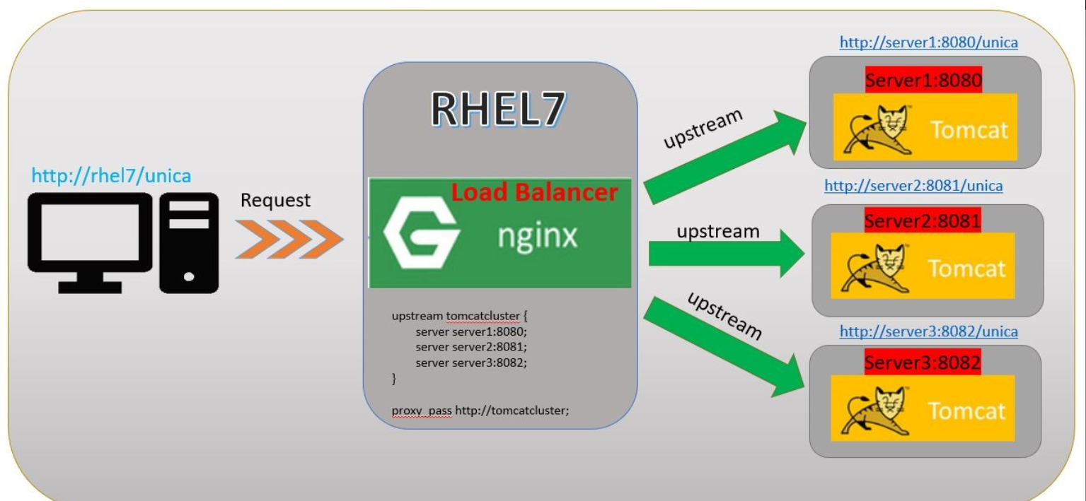

Architecture
- Tomcat Installation - server1
Download and install Tomcat server and listen on 8080
- Tomcat Installation - server2
Download and install Tomcat server and listen on 8081
- Tomcat Installation - server3
Download and install Tomcat server and listen on 8082
- Tomcat server1:8080
Install and deploy both HCL Unica Platform and Campaign and make it work with 8080 port.
- Tomcat server2:8081
Install and deploy HCL Unica Platform only and make it work with 8081 port.
- Tomcat server3:8082
Install and deploy HCL Unica Platform only and make it work with 8082 port.

- Round-robin
requests to the application servers are distributed in a round-robin fashion.
