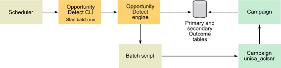

The following diagram illustrates the example described in this procedure.

Create the batch script to call the Campaign listener service, unica_aclsnr, to run a Campaign flowchart that you design.
Use the Opportunity Detect command line utility,
RemoteControlCLI (CLI), to run the workspace.
Use your own scheduling utility to run the CLI batch script at the desired interval; for example, daily.
When the workspace runs, Opportunity Detect inserts Outcome data into the Expanded Outcome tables.
