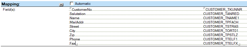

Field mapping
Keep in mind that the fields contained in an RFC/BAPI table are referred to by
concatenating the name of the table with the actual field name. As an example, note
that table CUSTOMER_T has the structure BRFCKNA1, as above in the section entitled
"Field Mapping".

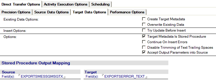

To access output parameter support for your Direct Transfer activity, select "Target
Metadata is Stored Procedure" and then select "Accept Return Values into Source".
This will display a field mapping section where you can enter field mapping that
will take data from the EXPORTS of your RFC, BAPI or TRANSACTION and send them back
to the Source.

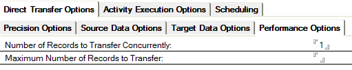

Note: When your Target is an RFC or BAPI and you enable the "Accepting Return Values
into Source" option, only one record at a time is transferred.
