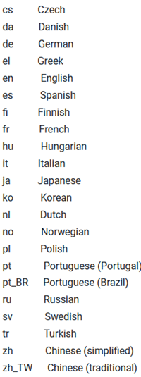

STCOUNTRYLANG=en |
The language to be used by the Connect client. Specify the language code for the language to be used. The default vlaue is English. If a value is not specified, the client computer's default language is used. |
