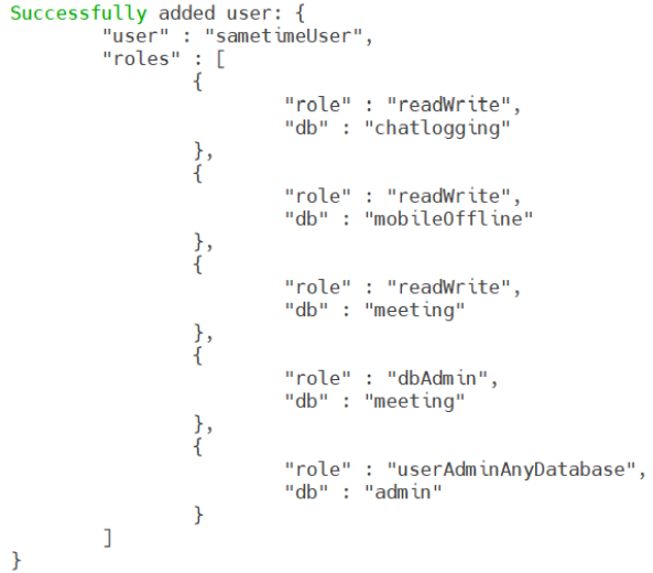

Run the db.createUser()method to add the cluster administrator. The
following example creates the user sametimeClusterAdmin with the
clusterAdmin role on the admin database.
db.getSiblingDB("admin").createUser( { "user" : "sametimeClusterAdmin", "pwd" : “sametime”, roles: [ { "role" : "clusterAdmin", "db" : "admin" } ] } )The following screen is displayed when the commands are completed successfully.
