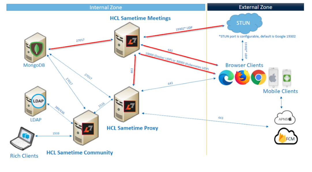

Meeting Server Connections
It’s important to review and understand the required Meeting server connectivity and ports. The image provided is highlighting these connections and ports. Ensure the Meeting server is not blocked or prevented from successfully making these connections.

- Confirm Port 10000 (docker) or 30000 (kubernetes) UDP is not blocked.
