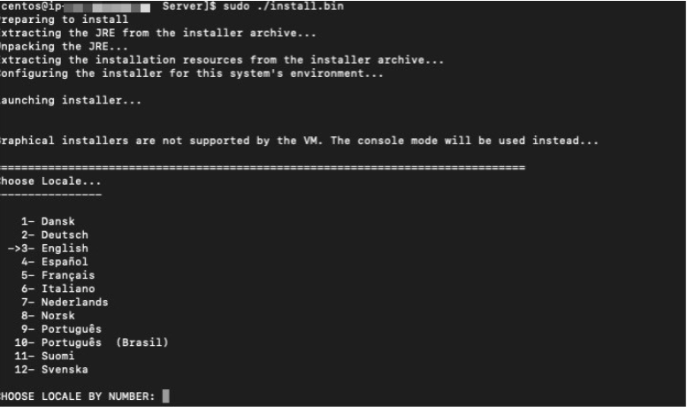

As the root user or sudo, execute the install program ./install available in the software package using the command:
sudo ./install.bin -
At the locale prompt, choose your server locale.

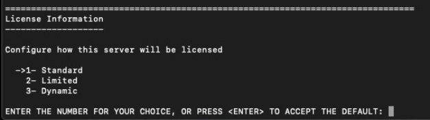

At the License Information screen, select the type of license you are installing. For HCL Sametime, choose Limited. For HCL Sametime Premium choose “Standard.” Do not choose “Dynamic”.

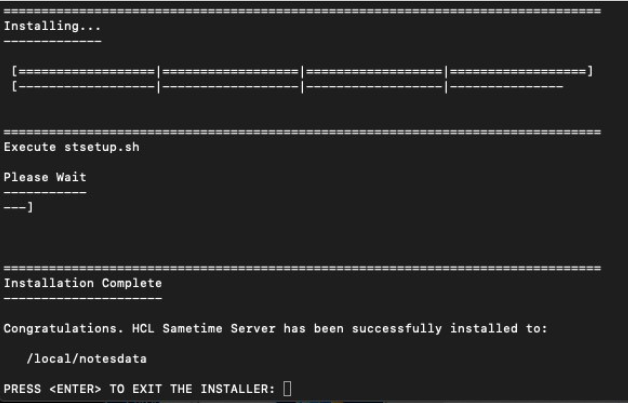

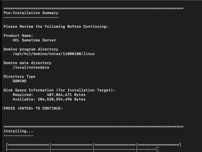

At the Pre-Installation summary screen review the selections and confirm they are correct. Press enter to continue.
- At the Installation Complete screen, press enter to exit the installer.
- Now that the installation is complete, start the server using the ./ststart script as the notes user. See the topic Starting and stopping the Community server for details.

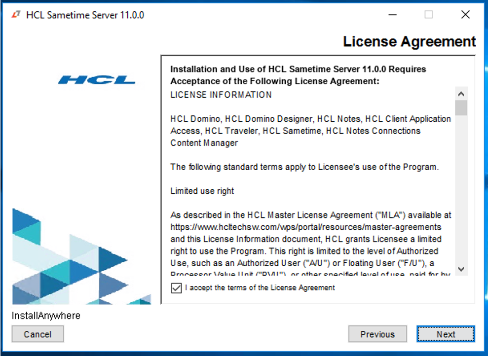

The license agreement screen displays. Click Next.

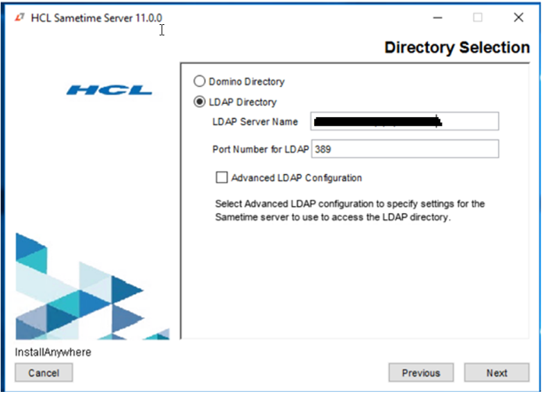

Select the Directory type you wish to use,
- If using the local Domino directory, click Next.
- If you select the LDAP Directory radio button.
- In the LDAP Server Name text box, enter the hostname of your LDAP server.
- In the Port Number for LDAP text box, enter the appropriate port for your LDAP server
- Click Next.

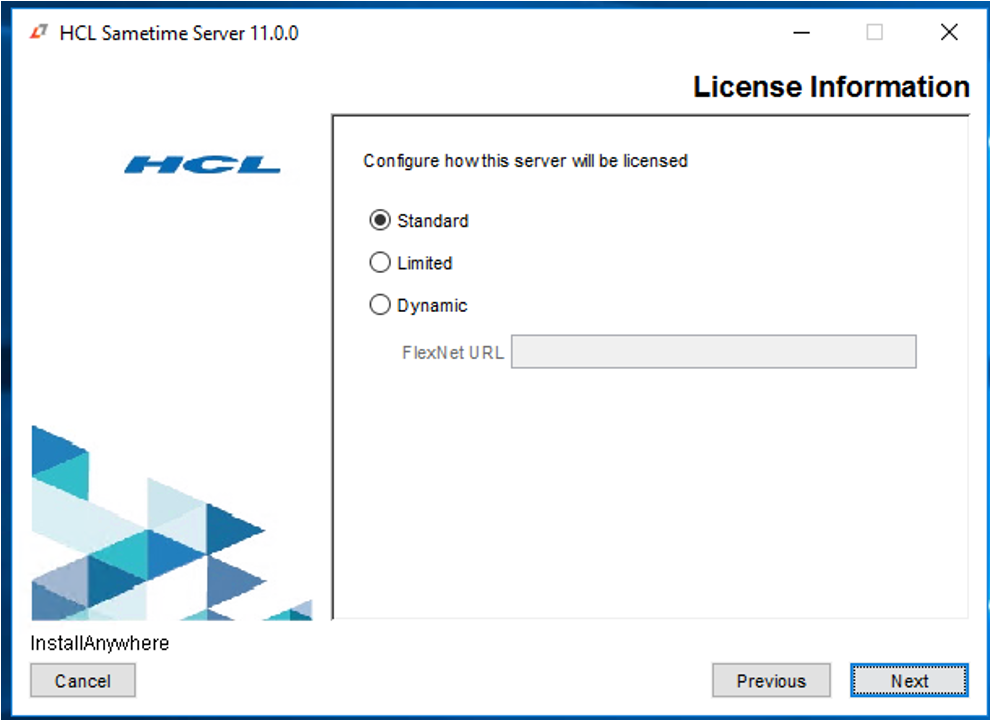

Select the radio button option in the License Information screen to configure the license. Click Next.
Note: You can choose either Standard or Limited depending on your license. Currently the Dynamic model option, where you can enter the flex net url is not supported for this release.

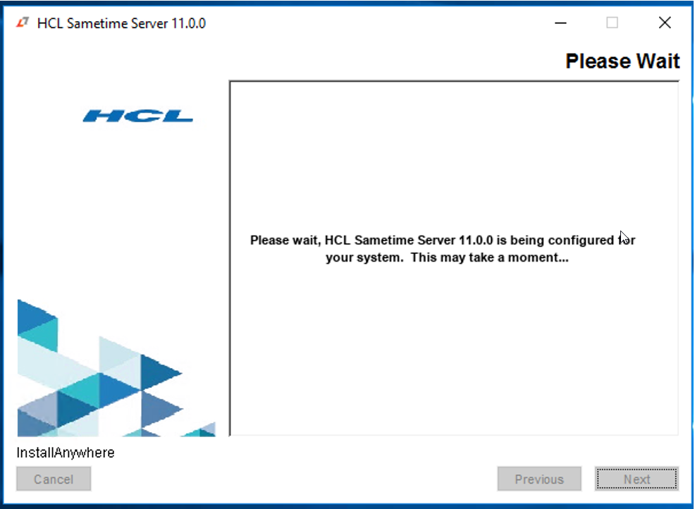

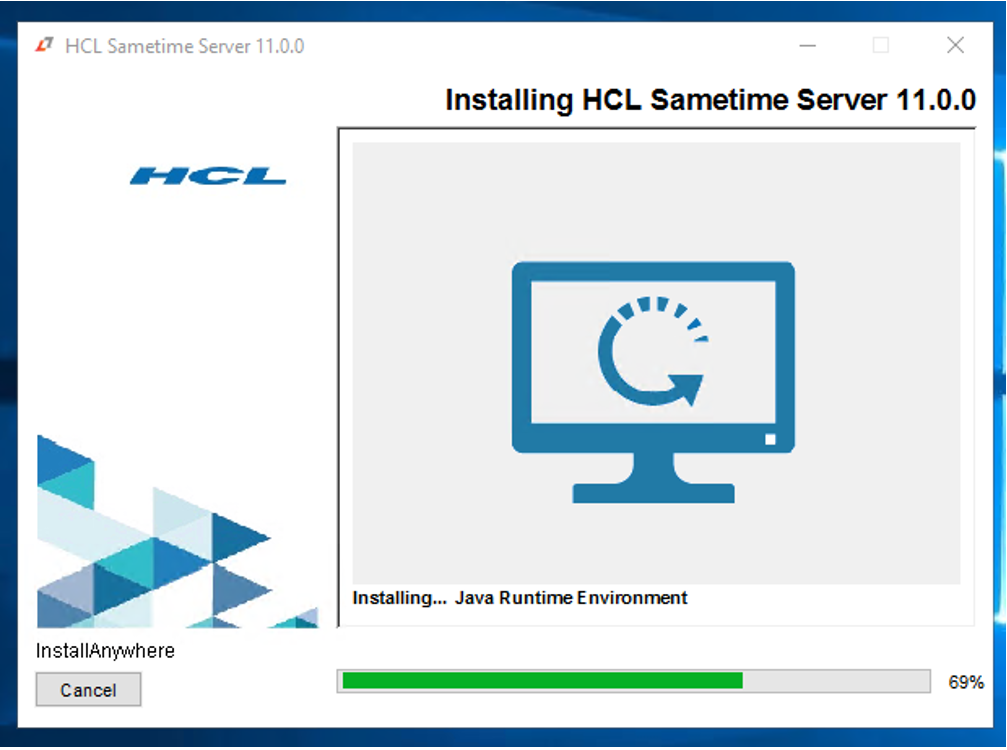

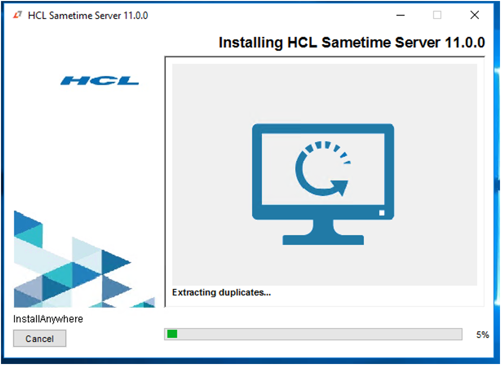

The installation begins.
Confirm the installation is performed without error.

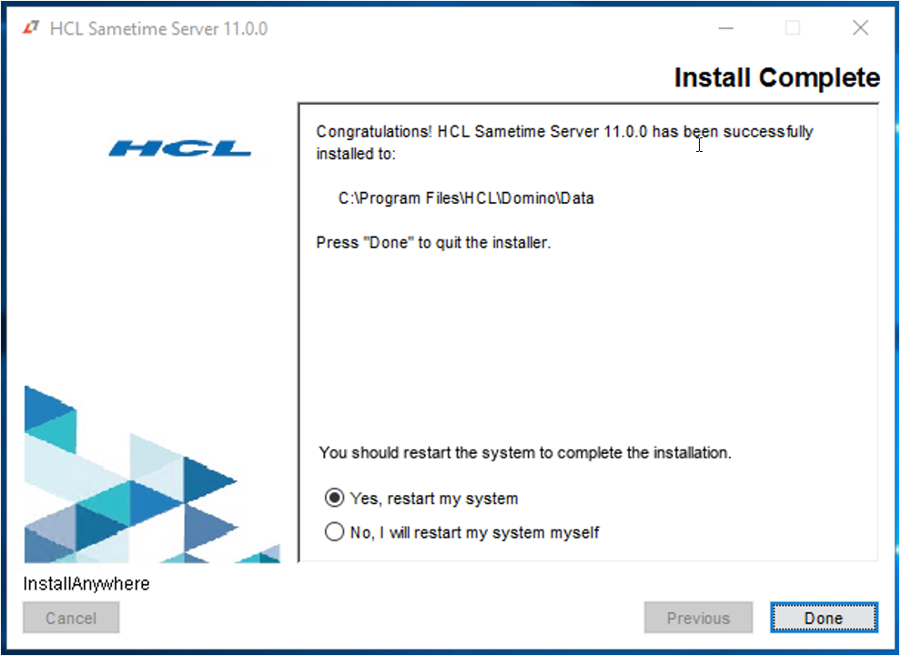

Note: You must restart the system to complete the installation. Select the radio button Yes, restart my system and then click Done.
The installation is complete.
