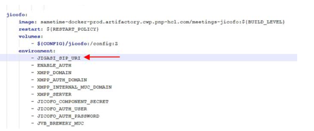

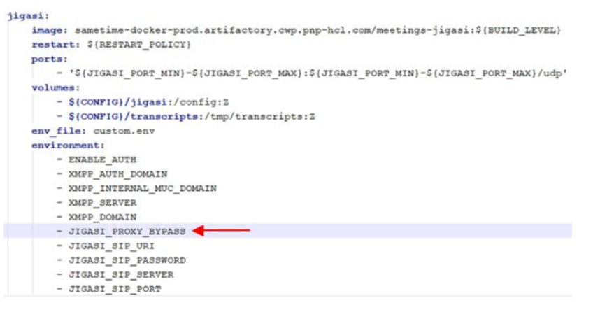

docker_compose.ymland save the changes.Note: The “-“ is required in front of the parameter.Under JIGASI environment section, add: – JIGASI_PROXY_BYPASS

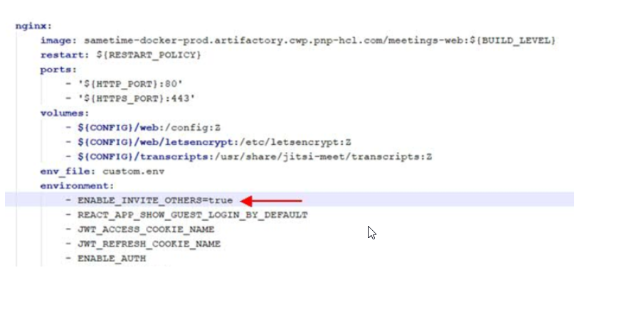

Under NGINX environment section, add: - ENABLE_INVITE_OTHERS=true
Under JICOFO environment section, add: - JIGASI_SIP_URI
