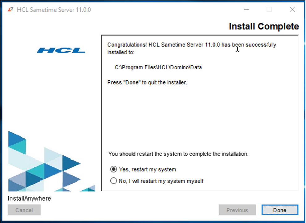

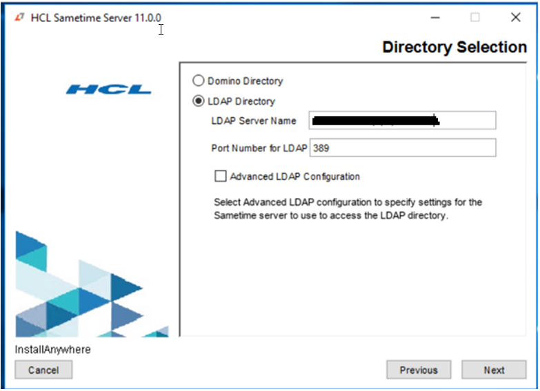

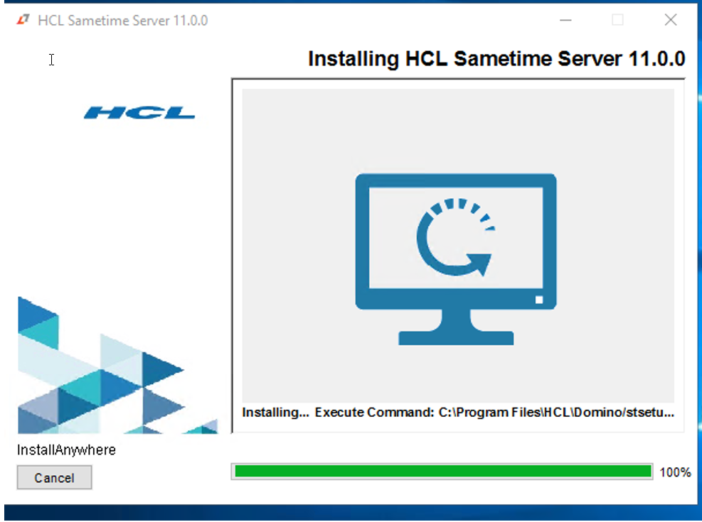

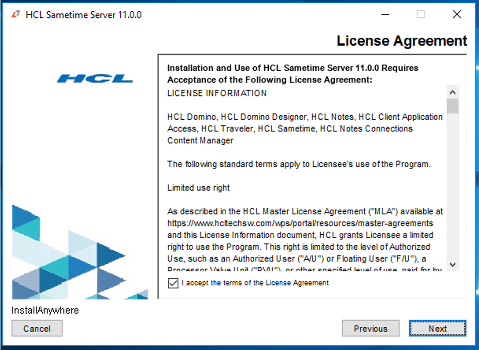

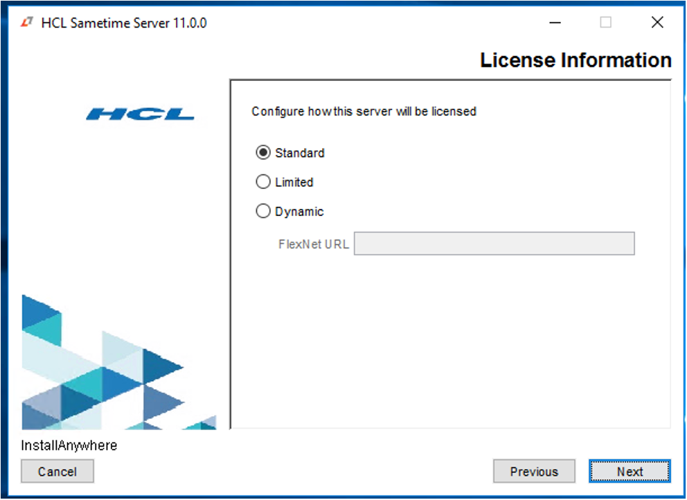

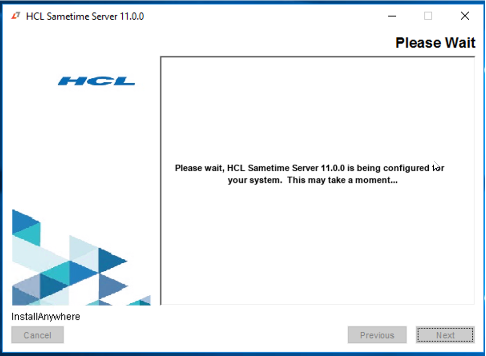

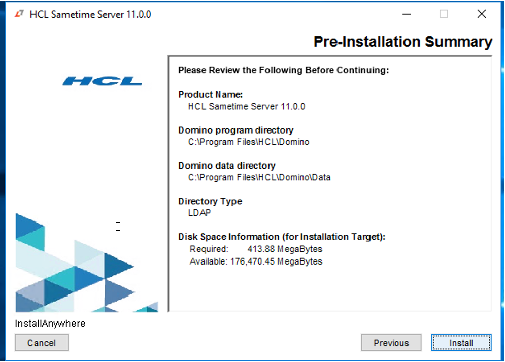

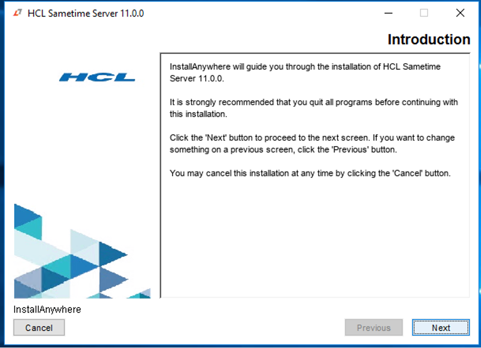

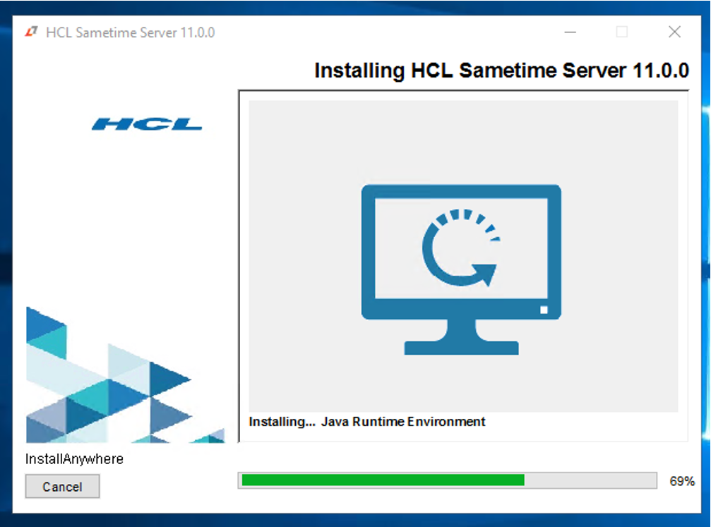

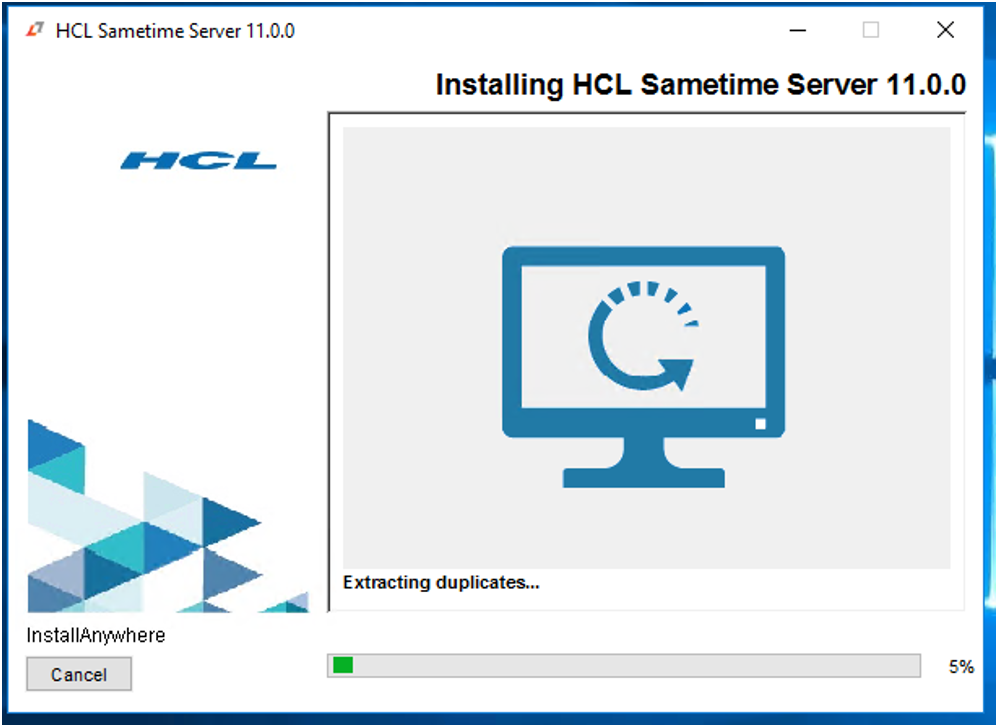

This topic guides you through the steps for installing the HCL Sametime Community Server.
To install HCL Sametime Community Server:
