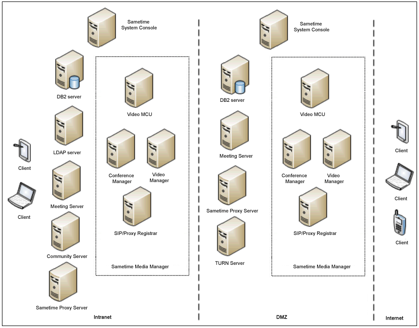

Make your Sametime® deployment secure in the extranet for customers, clients, or employees who are mobile. Sit down early with your Security and Network teams early to plan extranet access. Consider security best practices.
There is no "one size fits all" deployment scenario for extranet users. The way you deploy Sametime will determine which Sametime ports to use, which WebSphere® Application Server ports to use, and which ports to open in the firewalls.
Secure deployments use two firewalls, which define three security zones. The inner firewall isolates the organization’s intranet (the most secure zone), and the outer firewall creates a DMZ between the intranet and the Internet (the least secure zone). Deployment of Sametime is always dependent on your company's security requirements, capacity, and the features you want to install. If you want to allow users within your organization to meet only with external users connecting from the Internet, then you would install a Sametime Meeting Server outside the inner firewall so that it resides in the DMZ.

- Sametime System Console
- DB2
- Sametime Media Manager
- Sametime Meeting Server
- Sametime Proxy Server
- LDAP
- Sametime Community Server
- DB2
- Media Manager
- Meeting Server
- Community Server
