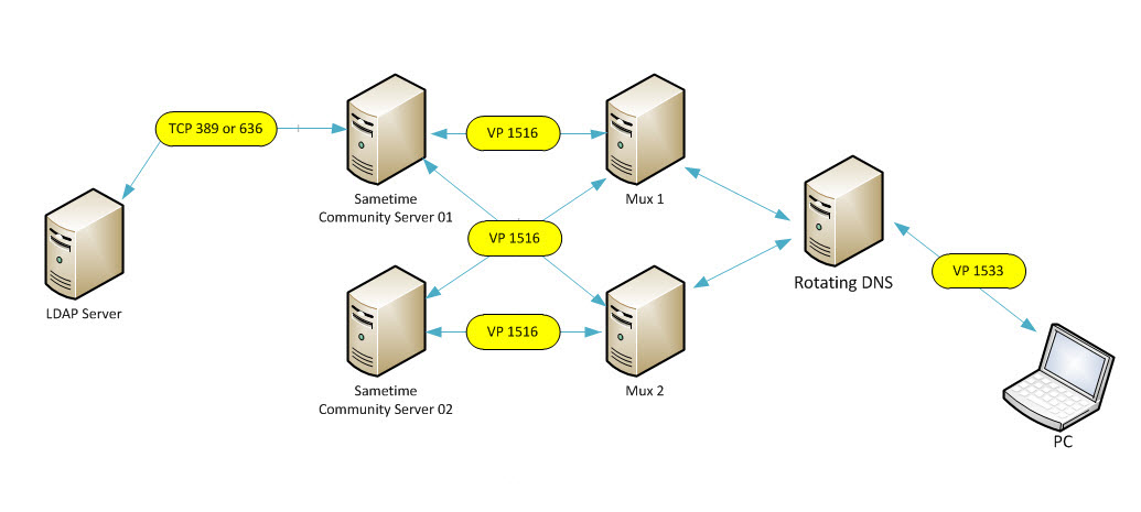

- LDAP Server
- 2 Community Servers
- 2 Community Mux servers
- Rotating DNS Server
- LDAP and Community Server: TCP 389 or 636
- Community Server 01 and Community Mux 01: TCP 1516
- Community Server 01 and Community Mux 02: TCP 1516
- Community Server 02 and Community Mux 01: TCP 1516
- Community Server 02 and Community Mux 02: TCP 1516
- Client and Rotating DNS: VP 1533
