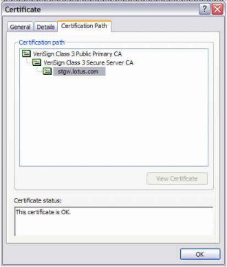

- Double-click on the new file that you created and a
Certificate dialog box opens.
- Click on the Certification Path tab.
- Look at the tree-like structure representing the full
certificate chain and determine whether your certificate was issued
by the root CA or an intermediary CA.
If your server
is listed one level after the root CA, this indicates that it was
issued by that root CA; otherwise the certificate was issued by an
intermediary CA.
For example, the following screen
capture shows a certificate chain where an intermediary CA, VeriSign
Class 3 Secure Server CA, issued a certificate for stgw.lotus.com.

- One you determine that the certificate is an intermediate
certificate, you must export the certificate from the chain into its
own certificate file:
- Double-click the server's certificate (i.e. server.cer)
file and a Certificate dialog box opens.
- Click Certification Path tab.
- Highlight an entry of the certificate chain.
- Click View Certificate.
- In the Certificate dialog window,
click the Details tab.
- Click Copy to File...
- In the Certificate Export Wizard that
appears, click Next.
- Select Base-64 encoded X.509 (.CER),
and click Next.
- Type in a unique name for the certificate you are exporting
and click Next. For example, "VS-intermediary-CA"
for VeriSign's intermediary certificate authority.
- Click Finish.
- Click OK in the dialog box that
displays the following message: The export was successful.
- Repeat the preceding sub steps for each intermediate
certificate in the chain. Note that there is no need to repeat these
steps for the last entry of the chain because the server's certificate
already exists. When you are done, you will have a certificate file
(.cer) for each entry of the chain.
