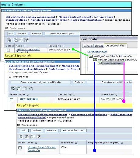

For example,
the following screen capture shows a certificate chain where an intermediary
CA, VeriSign Class 3 Secure Server CA, issued a certificate for stgw.lotus.com.

In our example,
there are three certificate files:
Table 1. Certificate types
and names
| Certificate type |
Name |
Certificate file name |
| Root |
VeriSign Class 3 Public Primary CA |
VS-root-CA.cer |
| Intermediary |
VeriSign Class 3 Secure Server CA |
VS-intermediary-CA.cer |
| Server |
stgw.lotus.com |
stgw.cer |
