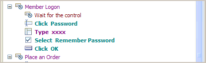

Click here to tag the Java snippet test lineis inserted after theClick Password. -
Select the inserted test line and replace the test line
text by typing
Wait for control. -
Drag the
Wait for the controltest line and drop it above theClick Passwordtest line so that Java code is executed before the password control is tested.
