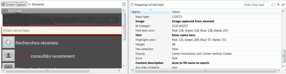

Object properties are captured during test recording and displayed in read-only mode in the Properties table of the UI Test Data view. To find an object in the application-under-test during playback, Rational® Functional Tester compares the properties of the object that are captured during the recording with the description of the properties that are displayed in the User Action Details area of the test editor. These properties are different for Android, iOS, or Web UI applications.

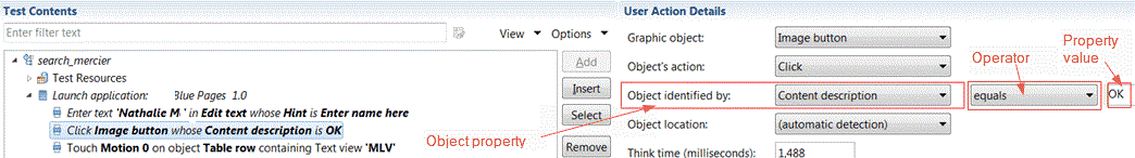

When you select a step in a recorded test, the test editor displays the object properties on which an action is performed. The object properties are listed in the Object identified by field, followed by the operator field and an insert field for the property value. Among the standard object identifiers, you can find Content, Class, Id, 'Xpath depending on the graphic object.
You can change these parameters (property, operator, property value) in the User Action Details area of the test editor or from the UI Test Data view by using the context menu. When actions are selected in the Test Contents list, the UI Test Data view is automatically synchronized to display the screen capture for the step selected. Properties can be modified in the Screen Capture tab, in the Elements tab, or in the Properties table by using the context menu.

Object properties are captured during test recording and displayed in read-only mode in the Properties table of the Mobile and Web UI Data view. To find an object in the application-under-test during playback, Rational® Functional Tester compares the properties of the object that are captured during the recording with the description of the properties that are displayed in the User Action Details area of the test editor. These properties are different for Android, iOS, or Web UI applications.
