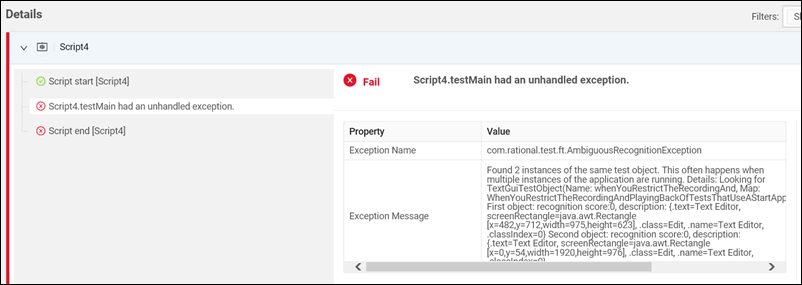

- When you expand a test by using the
icon in the
Details pane, you can view all the passed and failed
steps for each test. You can select each test step to view the details. Test
steps that fail with an exception are displayed with a highlight.
