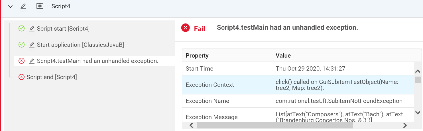

- Expand a test by using the
icon in the Details pane, to
view all the passed and failed steps for each test. You can select each test
step to view the details. Test steps that fail with an exception are highlighted.
- Use the Filters option to filter the passed and failed test suites.
- Click
to
navigate from the unified report to the workbench and view a specific test or

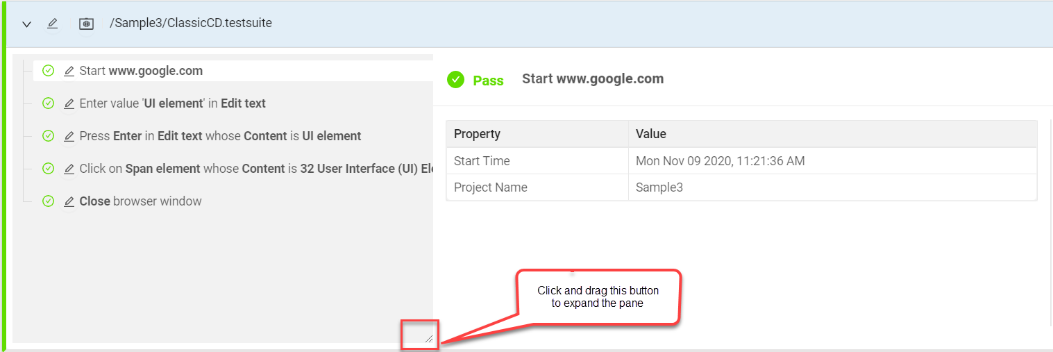

test step.Note: For a Web UI test, the test step is highlighted in the workbench. But for a Functional test script, the line number of the test script is highlighted in the workbench. - Click
in the test steps pane to expand and view the complete details of test
steps that have a truncated description.
