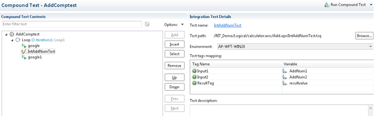

Modifying Rational® Integration Tester environments in Web UI Test perspective
In the compound test, you can select Rational® Integration Tester tests and change the environment of each test. The environments are set in Rational® Integration Tester, you can only change the selection from the edited compound test.
- Open the compound editor and select a test.
- In the Rational® Integration Tester
details, you can browse and change the properties of the selected test. The Test
path, the Environments and
Description are automatically updated accordingly.
- To select another environment for the Integration Tester test, use the dropdown menu.
Alternatively, you can change the environment selection for a test for a collection of tests:
- Right-click on the tree at any level under a node in the compound test and select Replace Rational® Integration Tester Environments.
- In the Set Invocation Tester Environments wizard, the first page displays
the list of projects that use the selected environment and the number of tests from project
that use this environment in the compound test.
- Select another used environment in the dropdown list. Click Finish. The new choice applies to the selected node and its children.

You can add a dataset mapper in the compound test for tests that are using multiple tags. See Adding Dataset Mapper to map tags in the Rational® Integration Tester tests with the variable values of Rational® Functional Tester.
