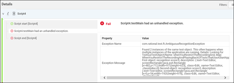

- When you expand a test by using the
icon in the
Details pane, you can view all the passed and failed
steps for each test. You can select each test step to view the details. Test
steps that fail with an exception are highlighted.

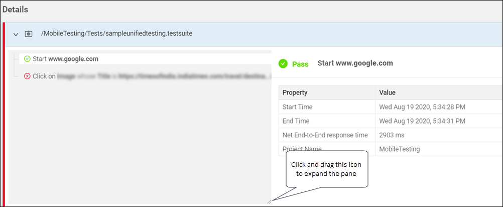

- You can use the resize icon
in the test steps pane to expand and view the complete details of test
steps that have a truncated description.
