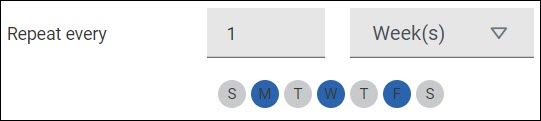

- Set the frequency at which the test runs must
run by entering the number in the
Repeat every field, and
then select the period from the list. You can
select from the following options:
- Minute
- Hour
- Day
- Week
- Month
For example, if you want the test run to be run every day at the set time, enter 1 and, then select the Day(s) option.
You can also schedule the test to run at the set time on specific weekdays by selecting the Week(s) option. For example, the following image displays the days selected for the test runs as Monday, Wednesday, and Friday:
