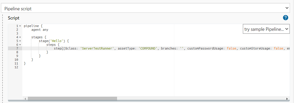

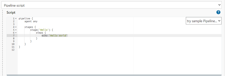

Select the sample script from the drop-down list.
For example, if you select Hello Word from the drop-down list, then the sample script is displayed as follows:
Specify the script that you created in place of
echo ‘Hello Word’
Note: You can provide a different name for the stage in the script.
