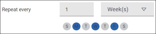

Recurring test runs Perform the following steps:- Click the Calendar icon
in the row of the
Start field. - Select the date.
- Select the time at which the test run must start.
- Set the frequency at which the test runs must
run by entering the number in the
Repeat every field, and
then select the period from the list. You can
select from the following options:
- Minute
- Hour
- Day
- Week
- Month
For example, if you want the test run to be run every day at the set time, enter 1 and, then select the Day(s) option.
You can also schedule the test to run at the set time on specific weekdays by selecting the Week(s) option. For example, the following image displays the days selected for the test runs as Monday, Wednesday, and Friday:
- Set the option to end the recurring test runs
- Select the Never option, if you do not want the recurring test runs to end.
- Select the On option,
and then click the Calendar
icon
. You can select the date and time after
which the scheduled test runs do not run.
- Click Save.
The recurring test runs are scheduled to start the first run at the selected time on the scheduled date, and to repeat the run at the frequency that you set.
