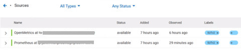

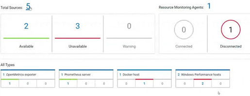

Click a source that is available in your project, either in the
Total Sources cards or in the All
Types cards from the resource monitoring page.
Click
under the Labels column of a resource monitoring
source to add a label.
Enter a name for the label and press the Enter key.
Example: Enter 'SUTv2' in three different resource monitoring sources.
Note: You can add one label or multiple labels for the same resource monitoring source. A label can contain a maximum of 200 characters.Tip: You can create the same label for different sources that belong to the same logical group to monitor the whole group with only one label. -

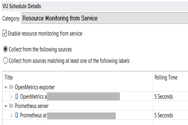

- If the Resource Monitoring from Service
option was not enabled in HCL OneTest™ Performance (see Figure 1), no source is available in HCL OneTest™ Server project.
Figure 1:
A message indicates in the Resource
Monitoring tab that Resource Monitoring was not
enabled. You can run the schedule with the resource monitoring
sources that are created and labeled in HCL OneTest™ Server (steps 1 to 6 in this procedure) by selecting labels that are in
your HCL OneTest™ Server project (step 6). - If the Resource Monitoring from Service

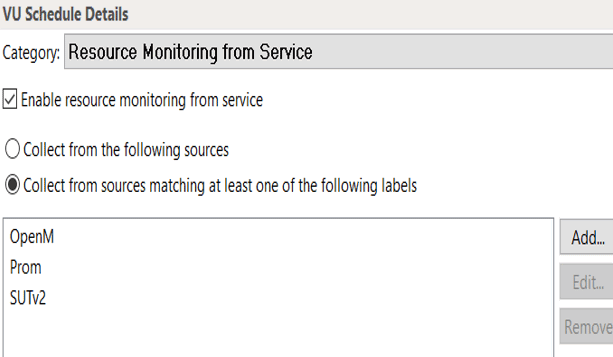

procedure). - If you added sources to your performance schedule by using labels in
HCL OneTest™ Performance (see Figure 3), the Resource Monitoring tab
displays the list of labels that are available in your HCL OneTest™ Server project.
Figure 3:
To select resource monitoring labels from your schedule, follow step 6 in this procedure.

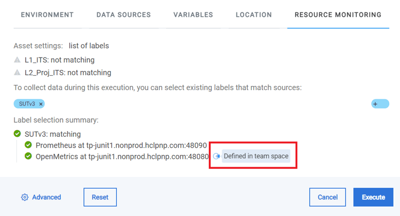

In the list of sources or labels that is displayed in the Resource Monitoring tab:- Green icons identify either labels that match the sources or sources that are found in the current project.
- Red icons indicate that the sources are not running,
- Yellow icons identify either labels that do not match the
sources, or sources that are not found in the current
project.
Data is collected for the sources that match labels only.
Click the
, and press the Ctrl + Space keys, or enter the initial letter of a
label to select a label in the list.
Example: Select 'SUTv3'.
You can see all the labels that you added to the resource monitoring sources in HCL OneTest™ Server.Note: You can select labels matching resource monitoring sources that are created in a team space in addition to the ones that are created in a project. - Select the labels that match the sources.
- Click Execute to execute the performance schedule.

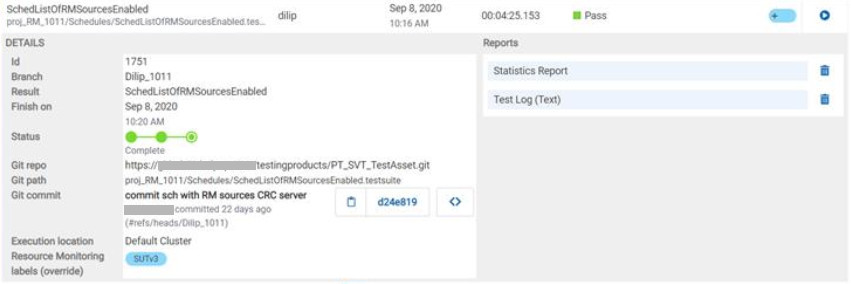

- Click the Result view in the navigation bar of HCL OneTest™ Server when the schedule is complete.
Expand the performance schedule result to see the resource monitoring label
name in the Details card.
The Details card displays the resource monitoring labels that are used in the schedule to override the initial labels and collect resource monitoring sources (in the example, the 'SUTv3' label). For other details about the Results page, see the link at the end of this page.

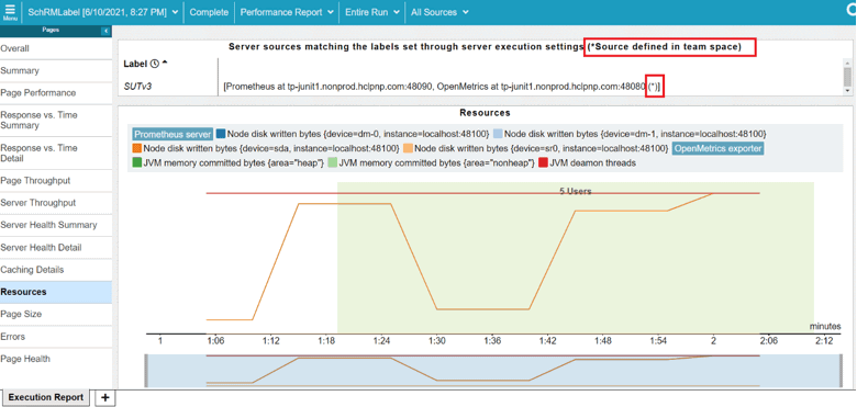

In the Report card, you find the link to the Statistics Report that is generated. In the Resource tab of the Statistics Report, you can view the information related to the Server sources matching the labels set in the schedule.
Click the Statistics Report link in the
Reports card to see the performance metrics of the
monitoring sources matching the selected labels.
Example: You can see the statistics for the sources tagged with the 'SUTv3' label.Note: In the Resources report, each resource name followed by an asterisk identifies a resource monitoring source that is defined in a team space.
