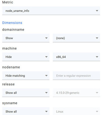

- Click the checkboxes to select counters in the Select OpenMetrics counters dialog box.

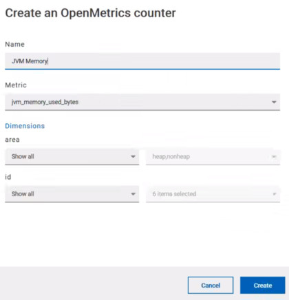

Follow these steps to create a counter:
Follow these steps to duplicate a counter:
Select a counter in the list, and click the
Duplicate icon
- Modify the name of the counter and the Dimensions.
- Click Create.
